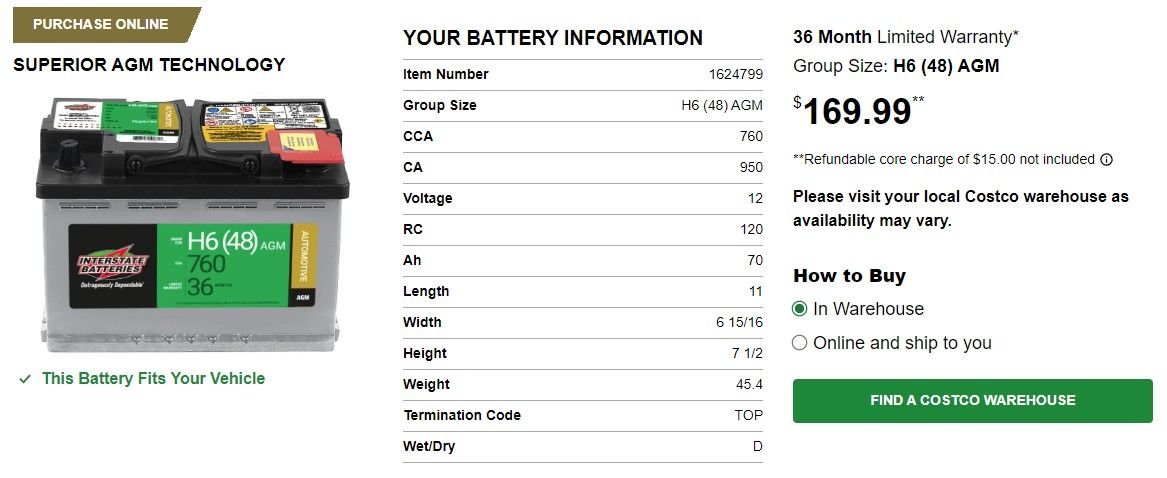

Old Dec 21, 2023 | 03:41 PM
  #44
waylo's Avatar
Joined: Oct 2016
Posts: 78
Likes: 10
2018 GLC 300 4MATIC
Originally Posted by ItalianJoe1
Yes it has to be reset on the newer cars. It will work without being reset but will shorten battery life.
Any idea on what model year this may have changed, what counts as a "newer" model? I have a 2018 GLC300, finally getting the low battery error signs. The internet is wildly varying on this question.
EDIT: Okay, after reviewing some of the documents found here and elsewhere, a 4/18/2018 released document states there were "technical modifications in the energy management system" and now a reset of the charge setting must now be made. Seems pretty official.
EDIT2: In terms of a consumer resetting the battery counter, it looks like the Foxwell NT530 described elsewhere may be able to do it. I have it on order from Amazon, will update to the latest software and report back on it.
Old Dec 22, 2023 | 06:45 PM
  #45
waylo's Avatar
Joined: Oct 2016
Posts: 78
Likes: 10
2018 GLC 300 4MATIC
As promised, an update.
After watching several Youtube videos on the battery replacement and the battery reset, it went off without a hitch.
Though this is a battery reset thread, here's the whole process I went through:
This the best video for battery removal/installation:

I purchased an Interstate battery from Costco. An attached sticker indicated it was manufactured in Germany. It has a 3 year prorated warranty. It seems to be not as wide as the OEM, but otherwise it installed fine.

Choose your options carefully.
There's an 800 CCA battery that fits and is widely available. It matches closer to the OEM battery. I went with NAPA Premium Legend #9A94R. 3 yr warranty. $205 on sale. The cheapest I found was thru Walmart.
To anybody else shopping for a OBD-II scanner, the Autel MX900 will easy reset the battery registration. This is a mid grade scanner that can be more useful later than an entry level Foxwell mentioned that works for only one vehicle. I caught the MX900 on a black Friday deal at $450 and it will scan multiple makes and models which I need along with a lot more capability. If you intend to keep cars more than 5 years, I see this scanner as a big help for DIY'ers.
