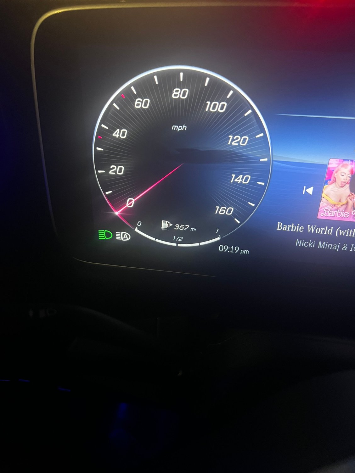

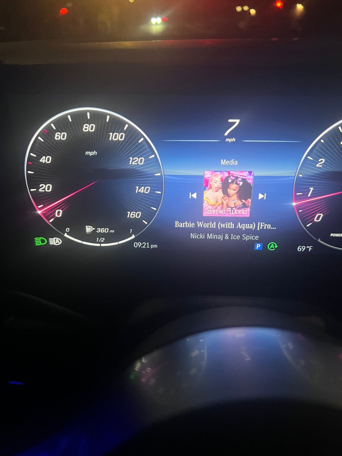

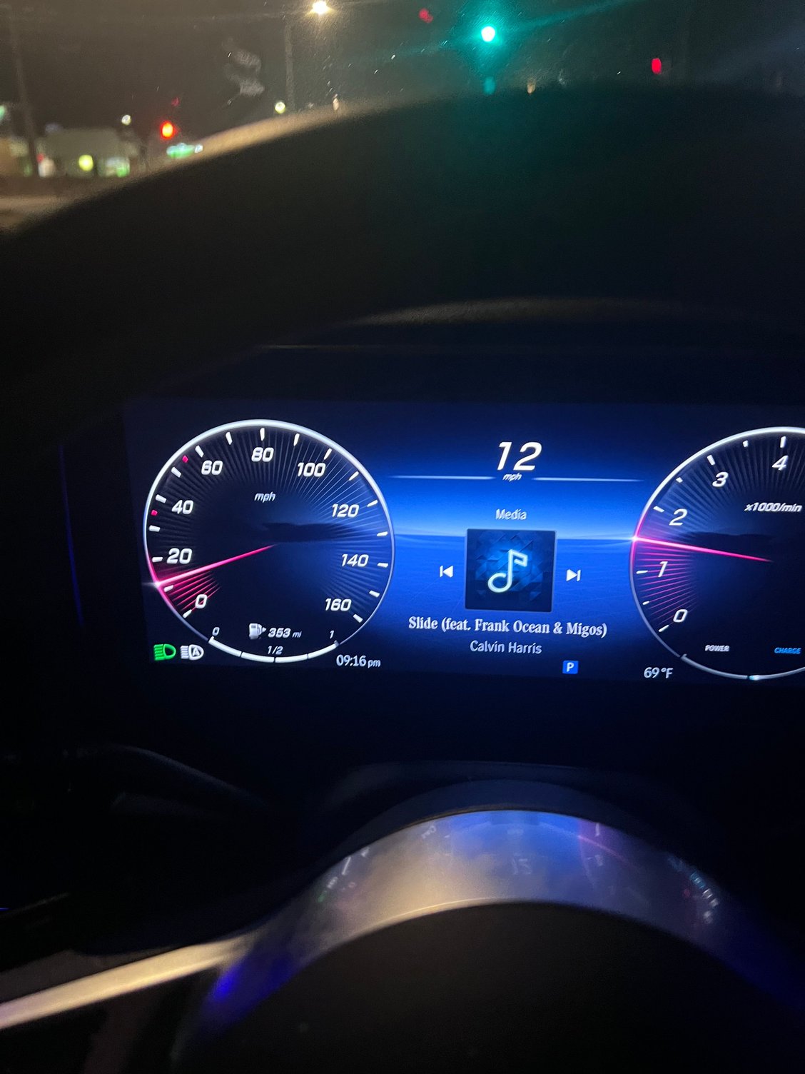

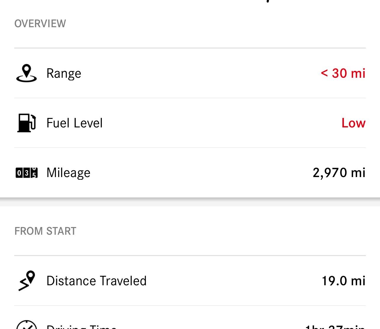

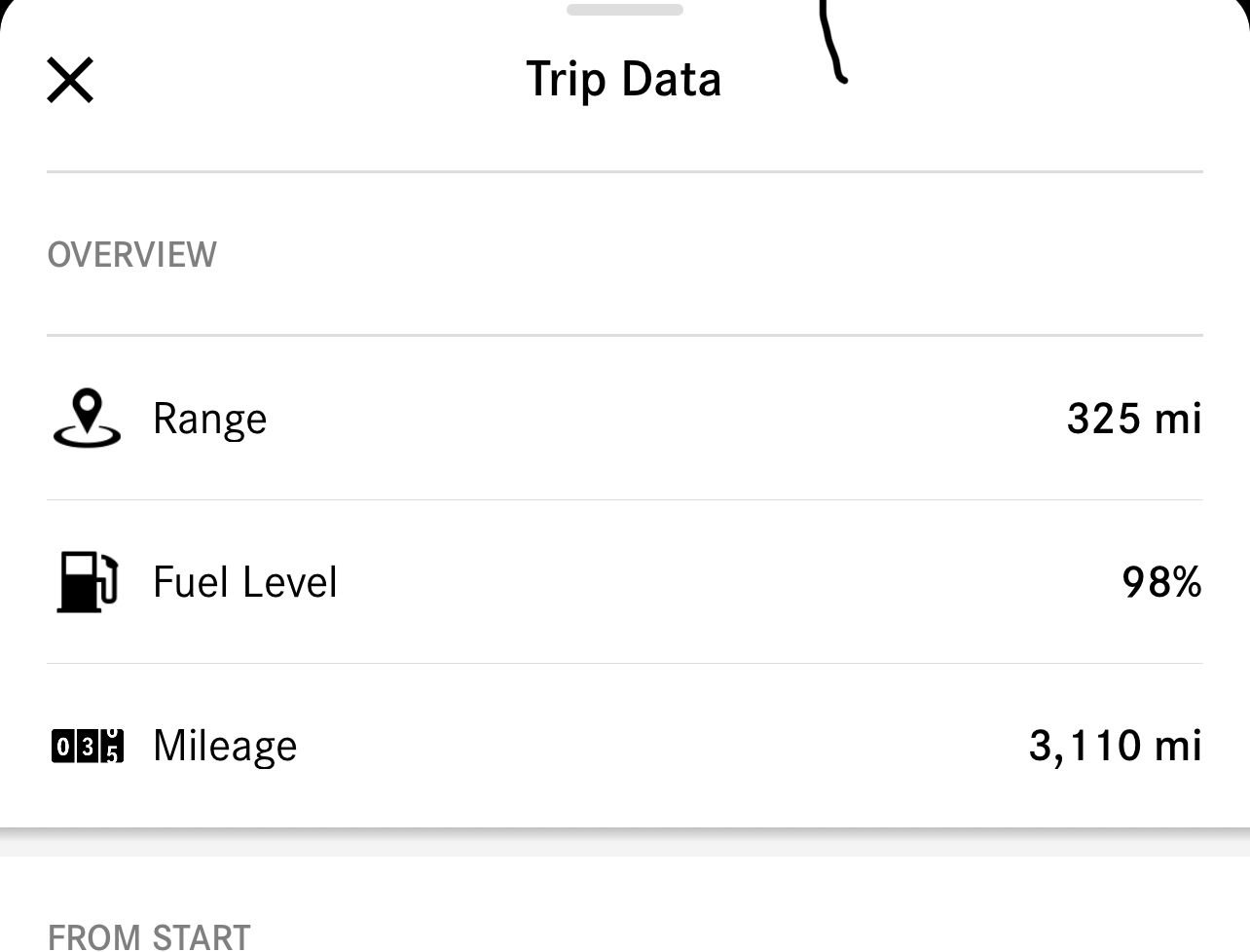

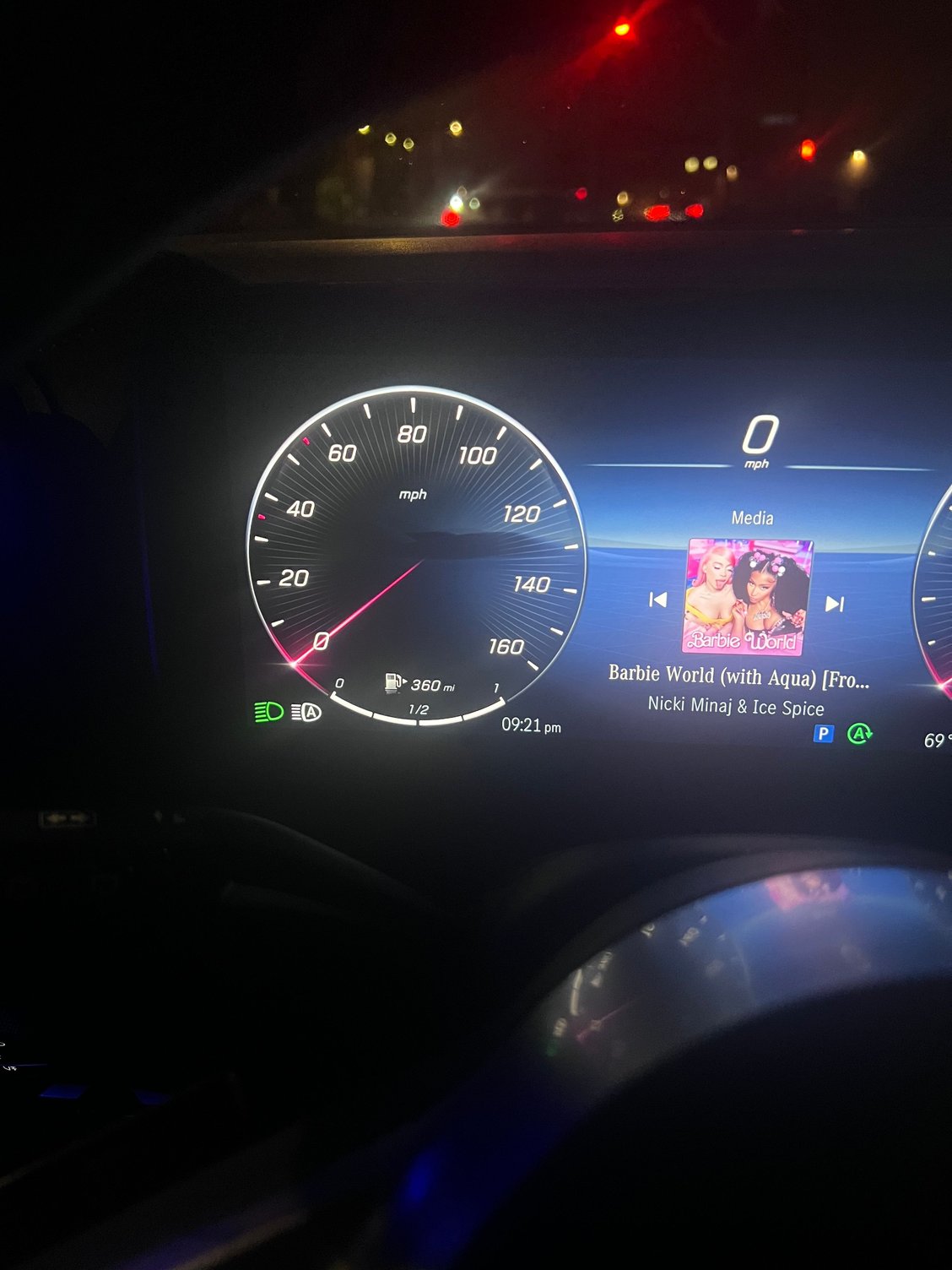

Thank you all so much for the information and apologies for any confusion or unclarity. Two weeks ago - about 2 hours after filling the tank to full, my check engine light came on and my miles to empty on my dashboard was 0. On the app it also says my fuel level was low. Because I filled the tank and drove about 4/5 miles I knew it was an issue because it was impossible for the fuel level to be low after resuming full and driving 4/5 miles. I had the car towed to the nearest dealer and they kept the car for 10 days- I just received it last week in 10/4 where the miles to empty read about 277 miles to empty.. Between picking the car up on Wednesday after to Friday morning I may have drove about 80 miles and the mileage to empty read 199. Later on Friday afternoon the miles to empty increased to 377. I drove about another 70 miles for the next few days and it the miles to empty either stays at a certain range or continues to increase. Currently it says I have a 99% fuel level which is impossible given the 100+ I’ve driven since I received the car back last Wednesday 10/4. I have not refueled yet. When I brought the car to the dealer two weeks ago I was at 2970 miles,currently I’m at 3010 so a 99% rating seems very inaccurate. I’m currently back at the dealer with the hopes of a solution or explanation. My VIN is saying there is not a recall.
When I brought it to the dealer about two hours after I filled the gas tank
What my car currently reads. I have not refueled the car at all.
