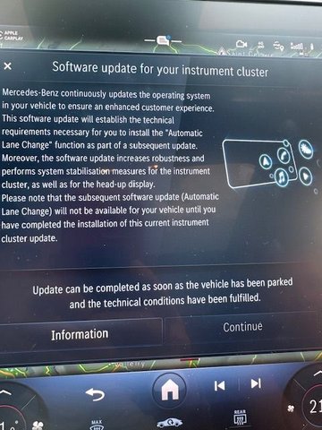

I got a msg to say that my s/w would be updated the next time the car was parked, but it's not happening, even several days later.
Instead - if I go to the softeare page in settings I get the details for what the update will do, but with this curious addendum of "äs soon as the technical conditions have been fulfilled"
"Continue" cannot be selected, but Ïnformation seems to question the condition of my battery......anyone have an explanation?

That's interesting. As you can see back in Feb I got a notice for an update. Unfortunately, it didn't complete the update and figured it would come back on its own, it never did. I never got all the screens you posted just the initial notice that it was available. The MBUX 2.6 update performed flawlessly. I figured the next time I go to the dealer they can check it out. Think you might want to visit the dealership!

Looks to be staged, usually going to the dealership or if you have access to XENTRY yourself, you can update manually.

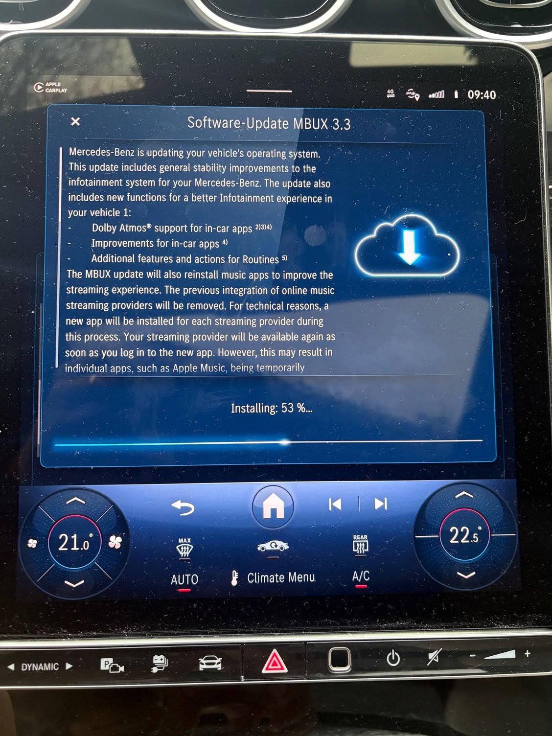

Instrument panel update? Interesting....
I got this MBucks one done in my driveway yesterday (3.3).
