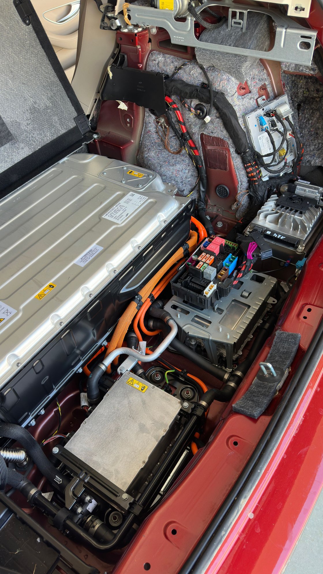

Do you mind sharing pictures of where in the trunk the unit is located? Is the location the same for the 2025 Mercedes GLC 350e? I'm glad to hear that you were able to fix the problem yourself!
Right side up right of trunk floor in the photo
