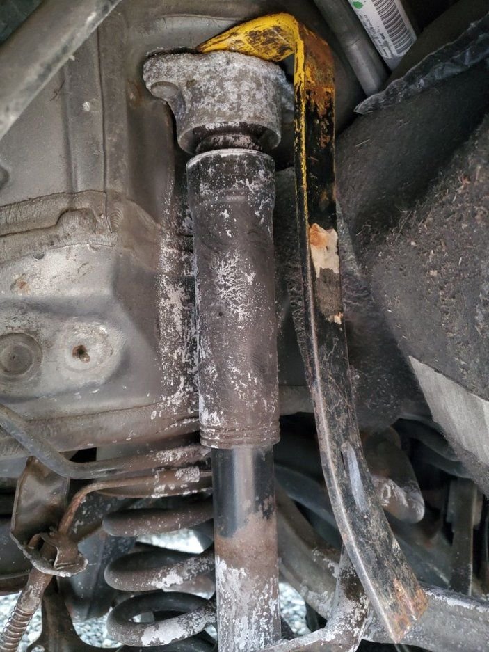

Heres what my rear brake lines looked like before I replaced them. Can see rust on the subframe and bolts. Think about all the dirt and sand that gets kicked up back there when driving.

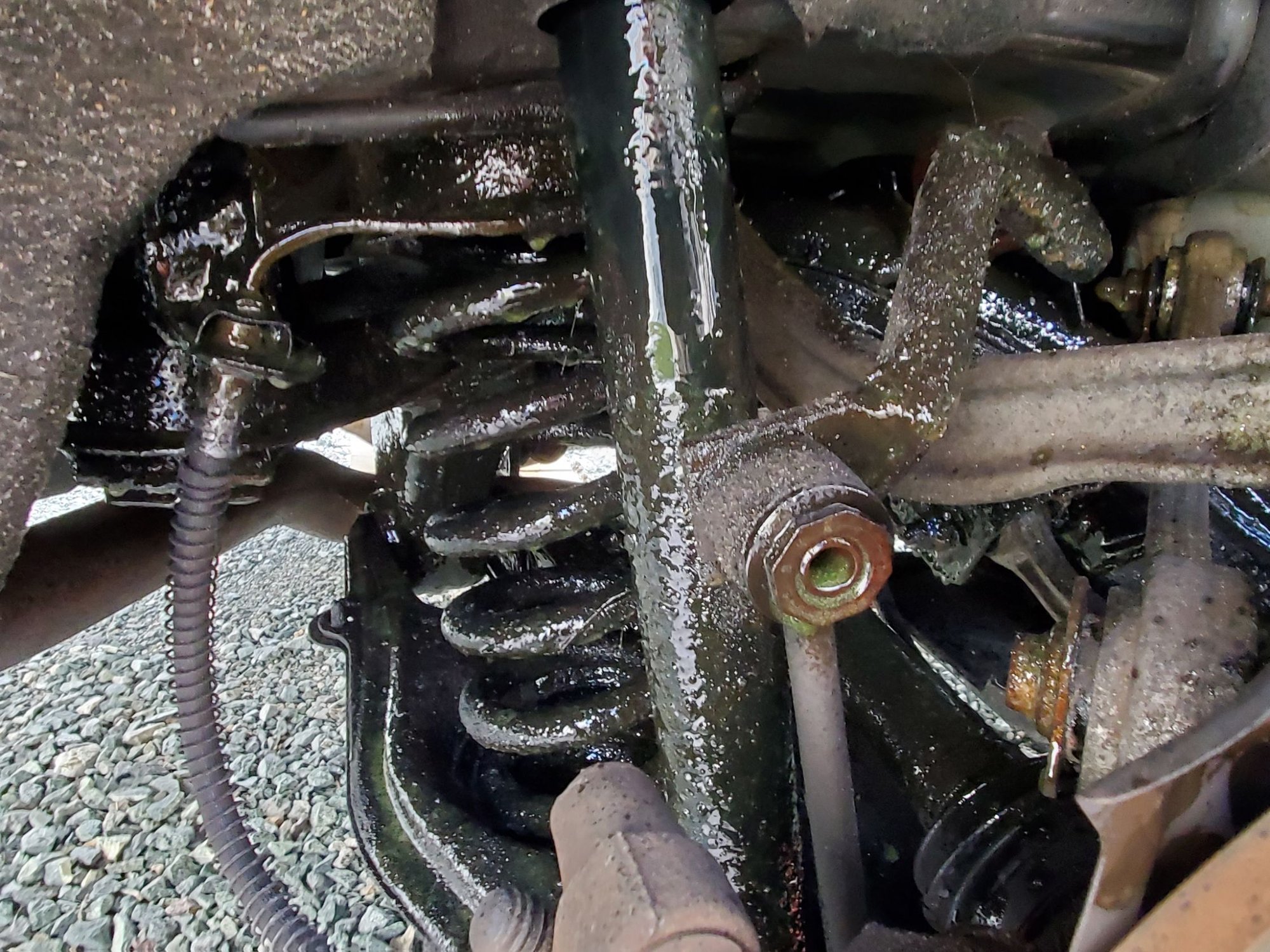

Heres what it looked like when I was replacing my old worn rusted shocks:

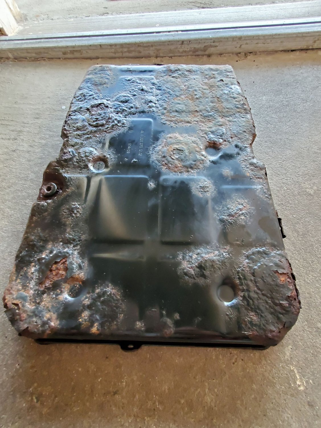

Rusted tranmsission pan:
Heres the new pan earlier today, I sprayed it with the CorrosionX HD last fall and its still on.
