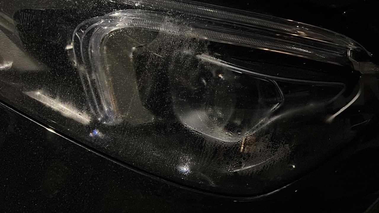

Some condensation in MB's headlights are actually normal according to the user manual.
https://cimg3.ibsrv.net/gimg/www.mbw...2dabe966aa.jpg
However, OP's one is excessive and clearly a faulty seal. Is yours the same level as OP's?
this is mine im sure this is classified as excessive
Hmmm so that is indeed more than usual, should indeed get it checked
