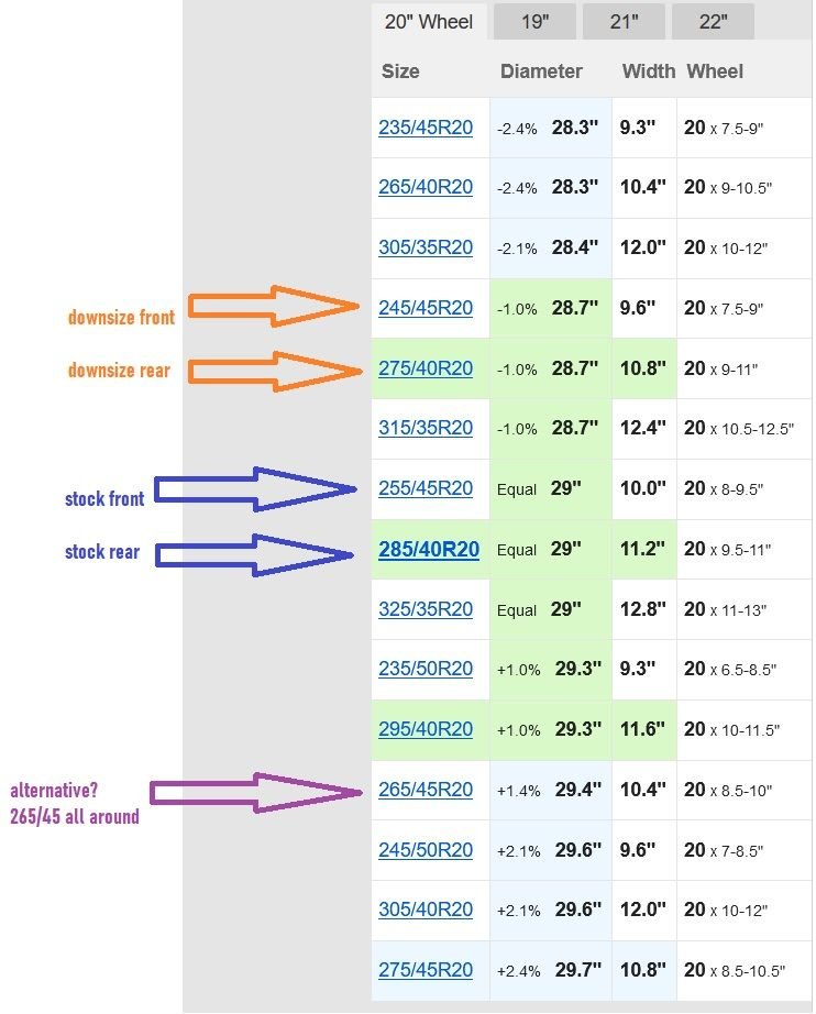

I have the stock 20" goodyear eagle run-flat tires, 285/40R20 and 255/45R20
There are literally zero options for all-season tires in that size, besides the very expensive goodyears
But if I downsized to 275/40R20 and 245/45R20, all my options open up. Looks like the diameter of each would only be 0.3 inches smaller.
Has anybody done that? Any potential issues with this idea?
USA here in case that matters

sounds like it should be fine since you would still be within 3% of the original diameter. Potential drawback might be less sidewall bead protection since the narrower tires will need to stretch out 0.5" more across the width of your stock rims.

Another interesting alternative, I found a 2017 GLC 43 for sale where they replaced all 4 tires with the same size - the sales guy told me they were 265/45R20 all round

Be careful. Use a rim & tire calculator, found on most tyre selling sites.
Your cars computer and safety systems, including auto transmission and 4Matic system may be voided.
Speed on dash may be higher, or lower, based on revolutions as well. MB spends $$$$$ in deciding tyre size - you might be better off buying 19” or 18” rims designed for the GLC, with correct ET and offset and buy cheaper tyres from a larger manuf range.
You could dump runflats and fit non run flats, several companies sell them.
I cannot believe there is only ONE tyre left in the USA that meets GLC specs.
Good luck, consider different rim sizes, just be careful re your transmission, etc.

Based on this chart I should be ok, either alternative will be within 1-1.5% difference in diameter from stock.
