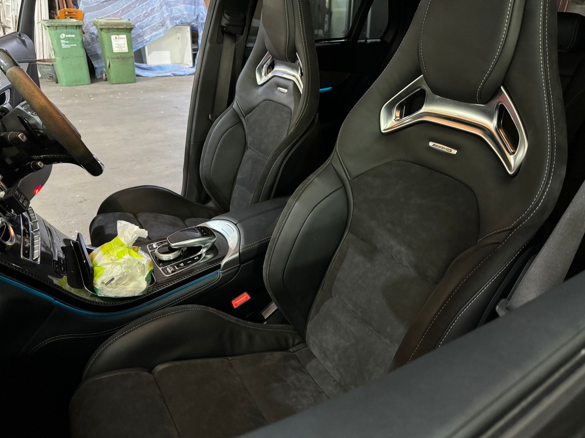

I have the AMG seats in my 2017 GLC43. You are correct to use back the seat control modules and will lose some of the original functions; including the seat position memory function as well.
