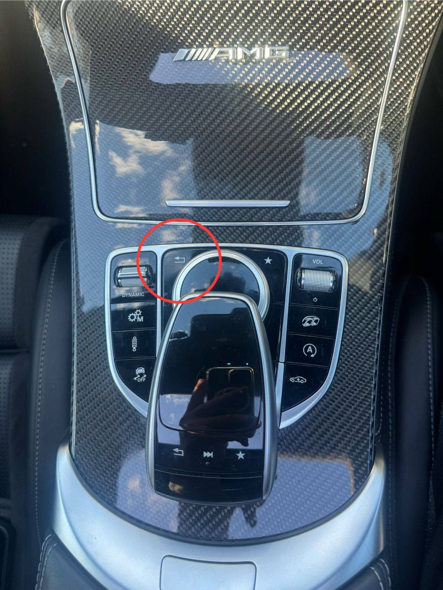

So, I did some further troubleshooting.
If I don’t connect my phone or ‘open’ the CarPlay screen, the car runs as it should. I don’t have any issues.
As soon as I open the CarPlay module on the screen (I need to hold down the ‘back’ button circled in my photo) and whether the phone is connected or not, this triggers something in the system and that is when I come into my climate control/dynamic drive issue.
Hoping with this extra info, someone might have a solution or suggestion on what to try next to work towards a solution.
As suspected, the aftermarket CarPlay module is the culprit. It's probably mucking with the CAN bus and causing data corruption. The CAN bus is the main network in a car through which all the modules communicate. It's kinda like the WiFi or Ethernet network in your house. The issue is that these modules have to intercept the traffic that's intended for the Infotainment system and redirect it to itself, so that when you are pressing buttons and using the jog wheel, the car's Infotainment system is not reacting to it while the CarPlay module is active. So something is likely going wrong there.
Problem is these modules are generally not certified to make sure they work correctly and are not causing issues in the car. It's like WiFi and Ethernet devices. There's a standards body that tests and certifies them to make sure they implemented the standard correctly and are not corrupting the network. That certification process is expensive, so these cheap modules skip it as the market volume is kinda small and would increase the cost by quite a bit.
Your options at this point are to remove the module or live with the issue. If you know who made it, you can try to contact their support and see if they are aware of the issue and have a solution.

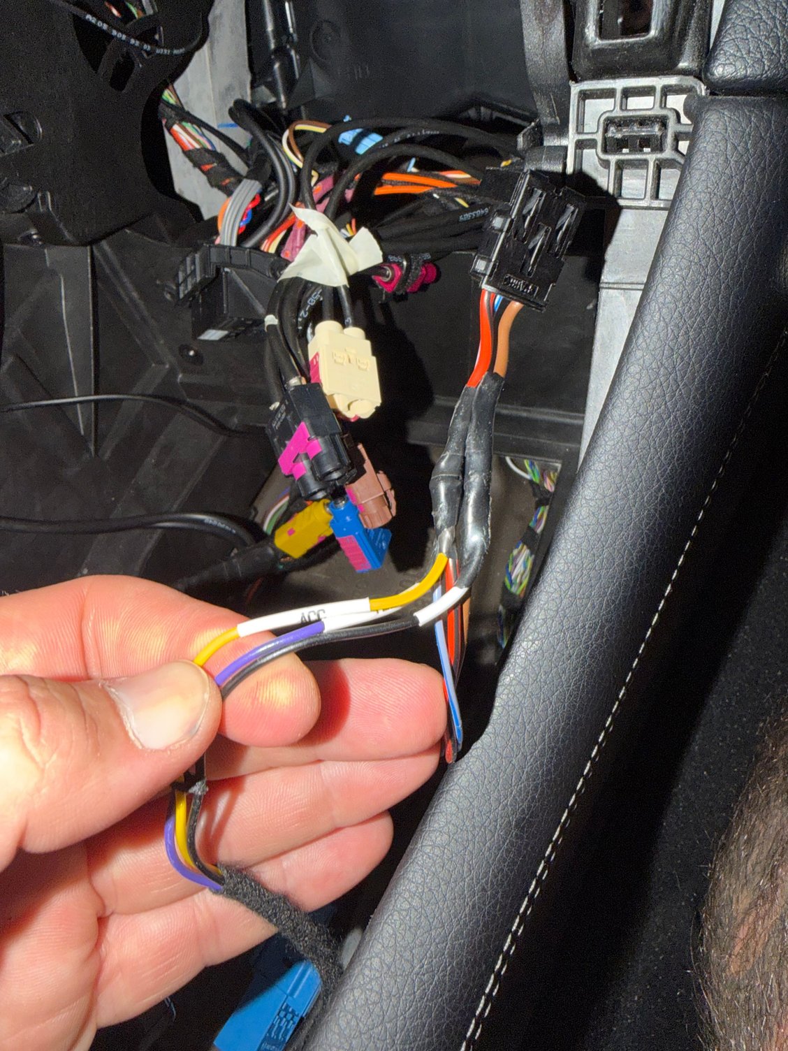

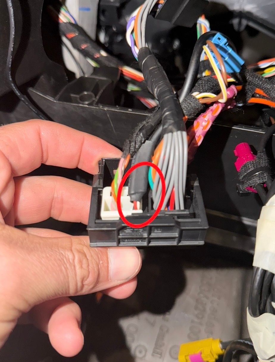

Digging up my old thread with some further info to hopefully get some insight to those who’re more electrical minded.
I have decided to remove the CarPlay module.
Whilst pulling it all out, I noticed a few questionable things.
1) they have tapped into the 12v socket connector with 3 wires labeled ACC, GROUND, ILL.
These will obviously need to be removed.
2) into the main harness going into the backside of the stereo, there’s a two wires which are connected to the CarPlay module but also connected into the harness. I’ve circled these two wires.
My question is, are those wires supposed to be there or can they just be pulled out?
I can post some more photos of those harness if it helps.
Thanks!

You best get a hold of the installation/wiring diagram for the module and reverse it. I haven't installed one of them myself, but based on the general understanding of how these work and installation guides I've seen, these things get spliced into the harnesses so it can intercept the video signal etc. and replace it with its own, meaning wires that used to go directly into the harness are disconnected and then connected to the module and a new wire goes back to the harness from the module. The wires in your second image for example look spliced, so just disconnecting them will most likely leave your stereo non-functional. You have to figure out how the original wires need to be connected back up, and the best way is to follow the installation guide in reverse.
I’ve tried searching for that diagram with no luck unfortunately + the original supplier was not interested in helping as they did not install the product.

For those of you following at home, I took a chance and disconnected any wires that didn’t look OEM and put the car back together and it was all good. Happy days.
I bought a new screen off AliExpress. Very skeptical at first but quite satisfied with the product.
Proceeded to then pull the car apart, again, and re install the new screen I bought and it works flawlessly. Haven’t had any issues yet. Car runs as it’s supposed to with no climate control issues or dynamic drive issues.
Unsure if this can be accounted to the previous module (Linux) being subpar or, which I’m leaning to, the fact that the previous module had been wired into the quad lock harness and other wiring, instead of a plug and play set up.
Nevertheless, all sorted and moving forward.
Thanks for the insight and assistance all!
