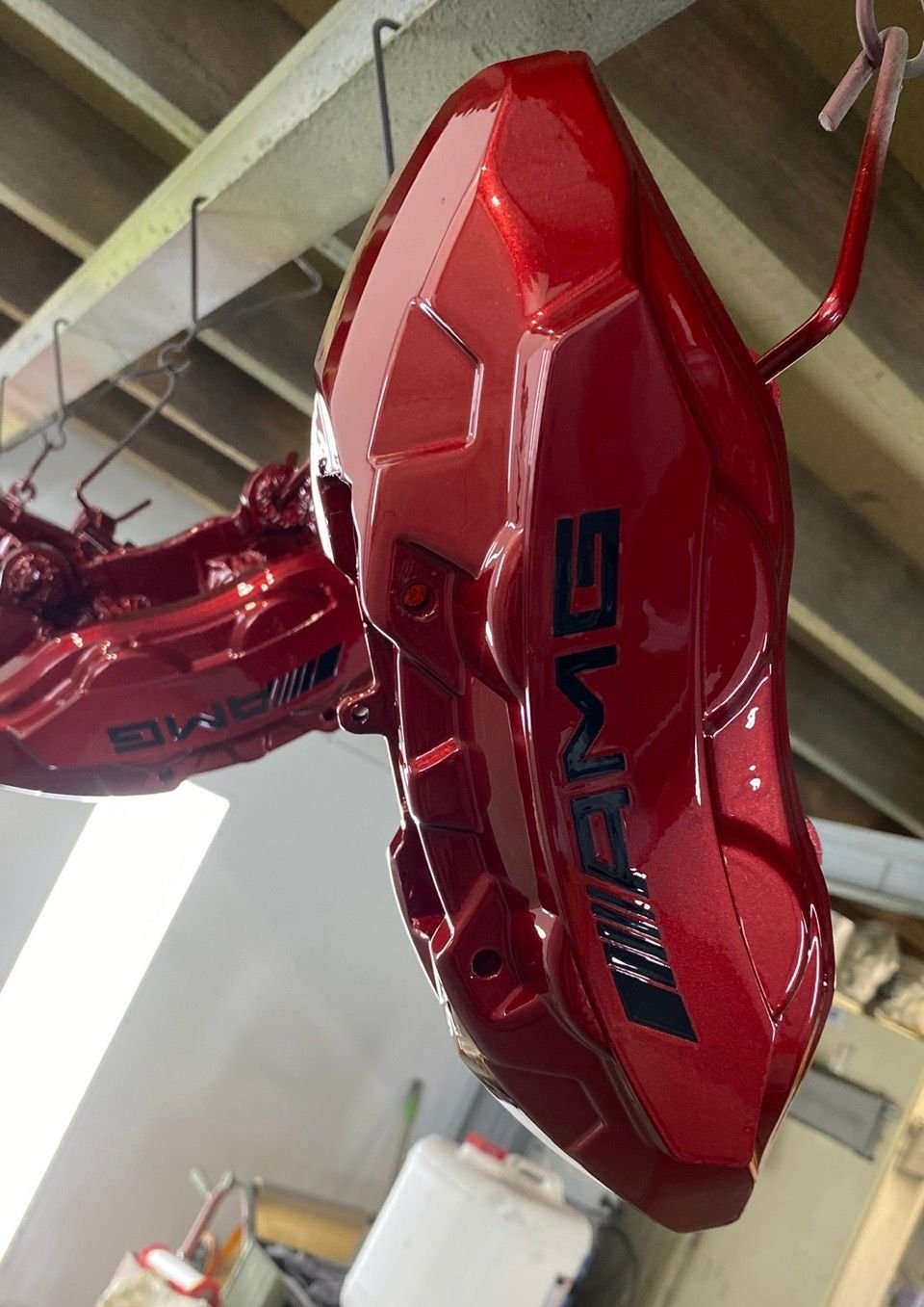

They are the same size rotors so would bolt straight on at a guess. Wouldn’t it be cheaper to get yours painted. The paint on them from factory is not that great. Paint them in automotive 2 pak paint. I did my wife’s in a clear over base.

on those red calipers that you painted, how on god's green earth were you able to paint the amg logo design nearly perfect in a contrasting color against the red background?
The AMG Logo is a sticker that you apply over top of the colour coat and then clear coat over it all.
correct you can purchase them on eBay for $10.
The ceramics are painted in a coppery yellow colour aren’t they. That is a whole another option on top of the S performance package.
