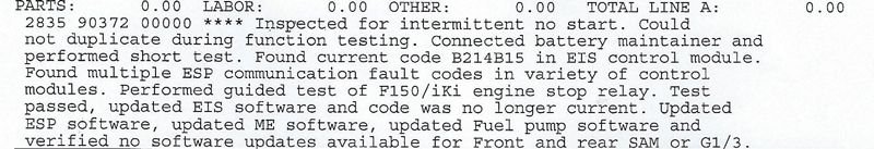

Failure to restart, again - UPDATE
Originally Posted by GregW / Oregon
My wife just called, and the issue for which our car spent 12 days in the shop a month ago has recurred. It would not turn over after being off for a while. Luckily I had shown my wife how to disconnect the battery to reboot it, which worked.
This is getting a little disconcerting.
I'm taking it back in next Monday and they are going to gather more data, do some software updates and open another case with Mercedes.
Update: Picked up the vehicle this evening after two days in the shop. They found several fault codes in various modules, including the Engine Ignition System. They performed multiple software updates. Let's hope this does it, for now. It would seem whenever you have you take it in the shop you need to have them check for updates, if they do not do it on their own.
We're off on a 400+ mile round trip to Seattle on Thursday morning, so hoping to have no incidents.
