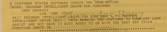

Mine was like that (I think all early builds were) until they applied a software update. I doubt that it’s a regulation since it’s not standard equipment but an option you pay extra to get. In areas that get snow/ice I view it as dangerous because it could result in an accident.
My question is why the brake correction? I also have Distronic and that feature steers you back into the lane. Why didn’t Merc stick with the normal way of Lane Keep correction?

Originally Posted by jsa1983
Didn’t know about that SW update. I will ask the dealer.
From my Dealer Service Invoice....

That post of mine you quoted was over a year ago. As I posted just before you today, a software update changed it to stay off when turned off.

I too hate the lane keeping assist. I took the above info regarding the service/software bulletin to the dealer and he could find no info on the patch from Mercedes. They also tried multiple ways to turn it off, but it still resets with the key off/on. I also tried the Mercedes complaint line and got nowhere. Frustrating that some of us can turn it off permanently but others can't. BTW, this is a 2020 GLE 450.

That’s crazy that the Dealer can’t find the update...wonder how hard they tried. Since it’s available to one Dealer it’s available to all. My 2021 GLE 53 came from the factory with the ability to turn Lane Keep off or on permanently.
