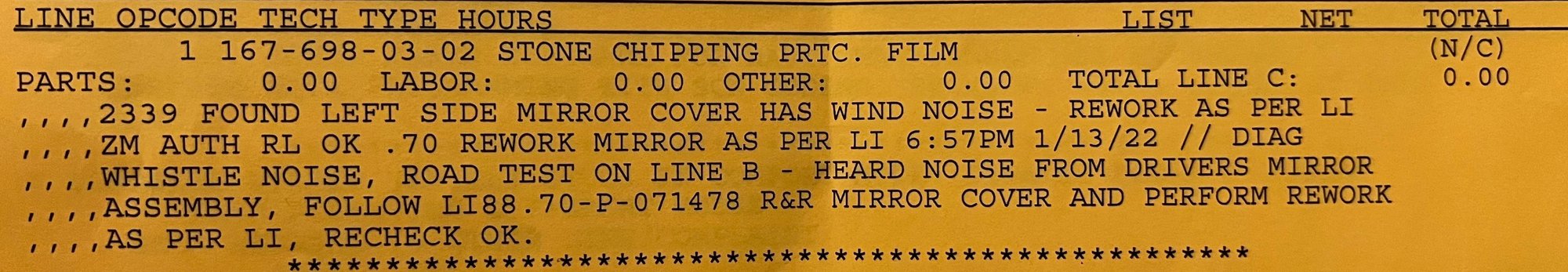

Finally had a chance to drive the car on the highway after corrective service for the whistling noise. See the attached picture for the service invoice - the noise isn't completely gone, but I would say 90%. Not noticeable at all if you have music / podcasts on at 70mph or higher (even at low volume). The trunk rattle was a lot more annoying. That turned out to be a loose bolt inside the third row seat. Software update resolved the slow loading screen (for now).
Tech speak for the whistling noise repair
