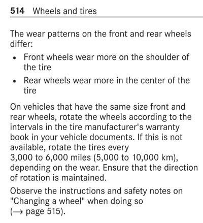

Here is what the manual says. Note that it says, "Ensure that the direction of rotation is maintained." This eliminates side-to-side swapping.

I wonder if "Ensure that the direction of rotation is maintained." refers to the pattern of rotating the tire locations, not the rolling direction of the tire?
I think that's a stretch; "direction" would not be used if they are talking about "pattern." That being said, I have always read it is okay to change the direction or rotation of modern steel-belted radials. This was not the case with bias ply or some early radials.
Note the first statement is rotate in accordance with the interval recommendation in the tire manufacturer's warranty book. I read that as if the tire manufacturer recommends cross rotation, do it. If they don’t recommend cross rotation (unidirectional, etc.) then don’t. The front to back statement to me reads like legalese...when in doubt, default to the a most safe option.
Perhaps but likely this is a German document translated to English so there is that to consider. In addition, many tire companies including: Michelin, Bridgestone, Continental and Cooper specifically refer to Rational Pattern in their discussion of tire rotation.

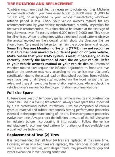

This is what Michelin hast to say on the subject:

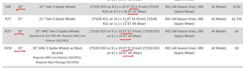

I have Bridgestone 275/50R20 Alenza Sport A/S RFT on my GLE 350 4Matic. Since I have the same tire size and offset on all 4 wheels, I plan to rotate them according to the Bridgestone tire warranty manual which recommends the following (pic on the left):

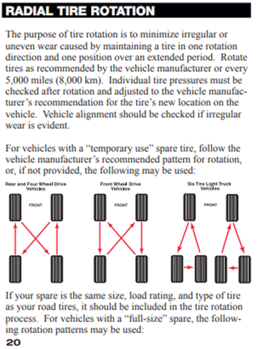

Originally Posted by TexAg91
I have Bridgestone 275/55R20 Alenza Sport A/S RFT on my GLE 350 4Matic. Since I have the same tire size and offset on all 4 wheels, I plan to rotate them according to the Bridgestone tire warranty manual which recommends the following (pic on the left):
I wonder what the difference is between the first two patterns as after 4 rotations the tires are where they started. I have used the 2nd method for many years on many vehicles with great tire life
Do you have OEM wheels? All OEM 20" choices have different front/rear offset.
Robert
The center pattern is for FWD, where as the left pattern is for RWR/4WD. I too was surprised by a different rotation pattern for FWD vice RWD/4WD, the wear difference between the two rotation patterns has to be miniscule.
I have the 10 spoke 20" wheels (50R) -- they the same as the 5 spoke wheels -- different offsets? That's going to be a news flash to me....as I thought they were the same.

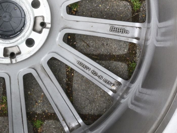

Well Crap, twin 5-spoke wheels = 10 spoke wheels!!!
I thought the 8.5J was the offset, I see it's the ET (which is not on the tire placard in the door jam). Thanks for the check 6 -- fortunately I have the dealer do the rotation anyway...hopefully they would know the difference! So, they're going to have to remove the tires from the rim and rebalance...GREAT!
Not sure why Mercedes went this way; never had that on all my previous MLs. Very inconvenient. Seems like there should have been an engineering solution that avoided that. And, hopefully the dealer knows this, but would not count on most tire shops to. The offset (ET) is stamped on the back of each wheel.
If they wanted to offer the wider tire option on the AMG models, they had to make the rear offset less on the 20" models so the tires came out to the same spot.
I've got a coworker whose winter set of 20's on his AMG are all the same offset and the rear wheels look goofy all set in like they are.

Originally Posted by Crispin
If they wanted to offer the wider tire option on the AMG models, they had to make the rear offset less on the 20" models so the tires came out to the same spot. I've got a coworker whose winter set of 20's on his AMG are all the same offset and the rear wheels look goofy all set in like they are.
That's why I'm running 12mm spacers with my rear winter W166 20s. Matches offset of OEM 20s.
