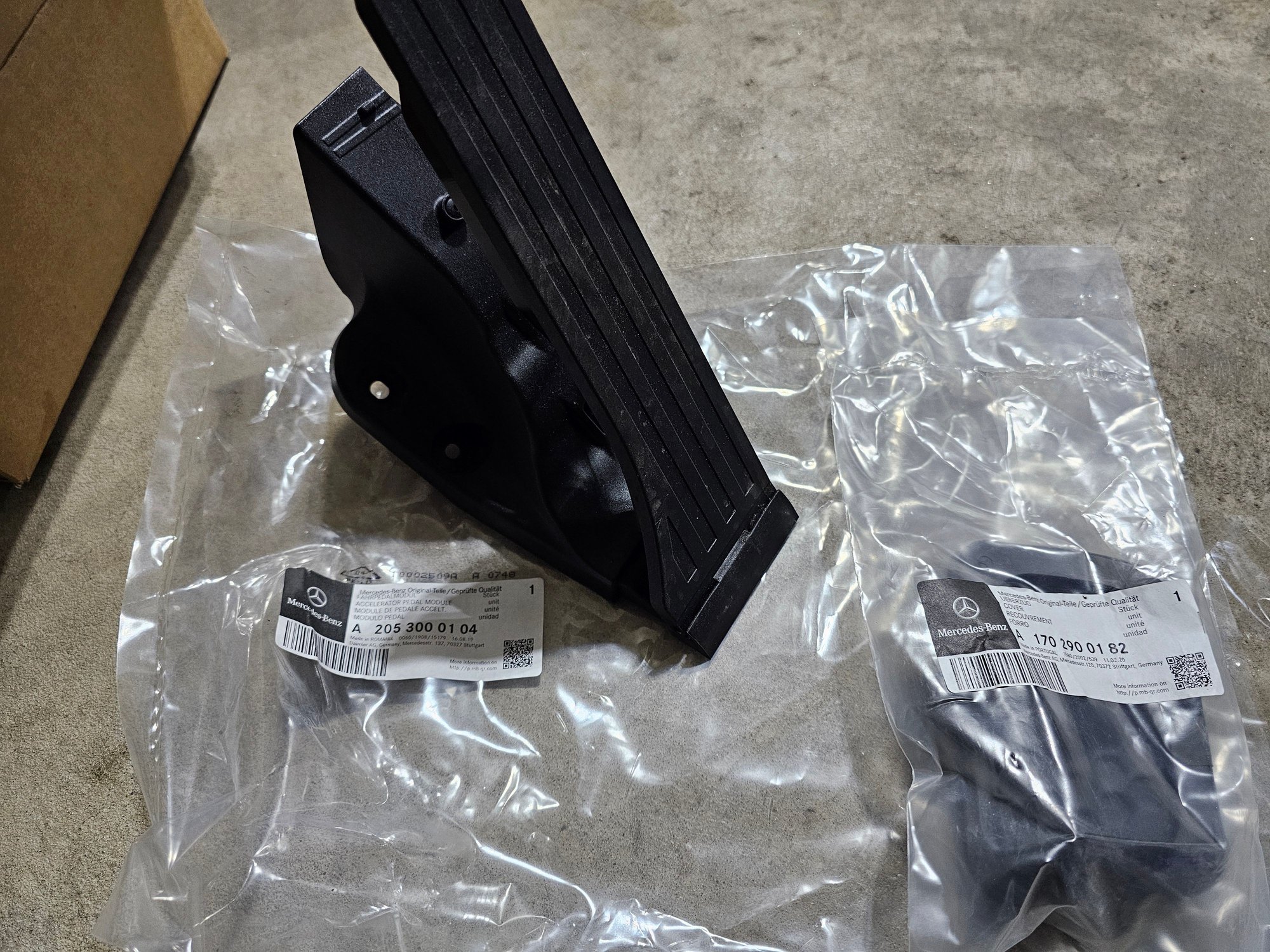

I know this is an old thread, but I just ordered the sport pedals. Do you happen to know the part number for the other part needed for the accelerator besides the pedal?

It should include both if you get the assembly. The brake is just a "face swap", the accelerator is the entire unit where you need to unbolt the old one, disconnect, and reinstall the new one. Those part numbers are for the 2020. You could also get the two separately.
(image shown are the old part, those that came out of my car)
Thanks! So when you order the pedals, it comes with the assembly for the accelerator? I had ordered the same part number in your photo. I canceled the order thinking it was just the pedals and didn't come with the assembly. If it does come with the assembly for it, then I'll reorder it.
If you order the assembly (part number on box), it comes with both parts (the 2 parts with part number on bags).
