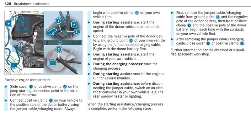

Ron, in the owner's manual it shows hooking up a charger to the connectors under the hood for charging the AGM battery/48 volt battery?
You can also boost the car if it doesn't start? Do you know if these posts under the hood lead to the AGM battery then though the voltage converter and into the 48 volt battery also?
I know there has been discussion on this but it's been quite varied.
Toban
I believe that is correct.
