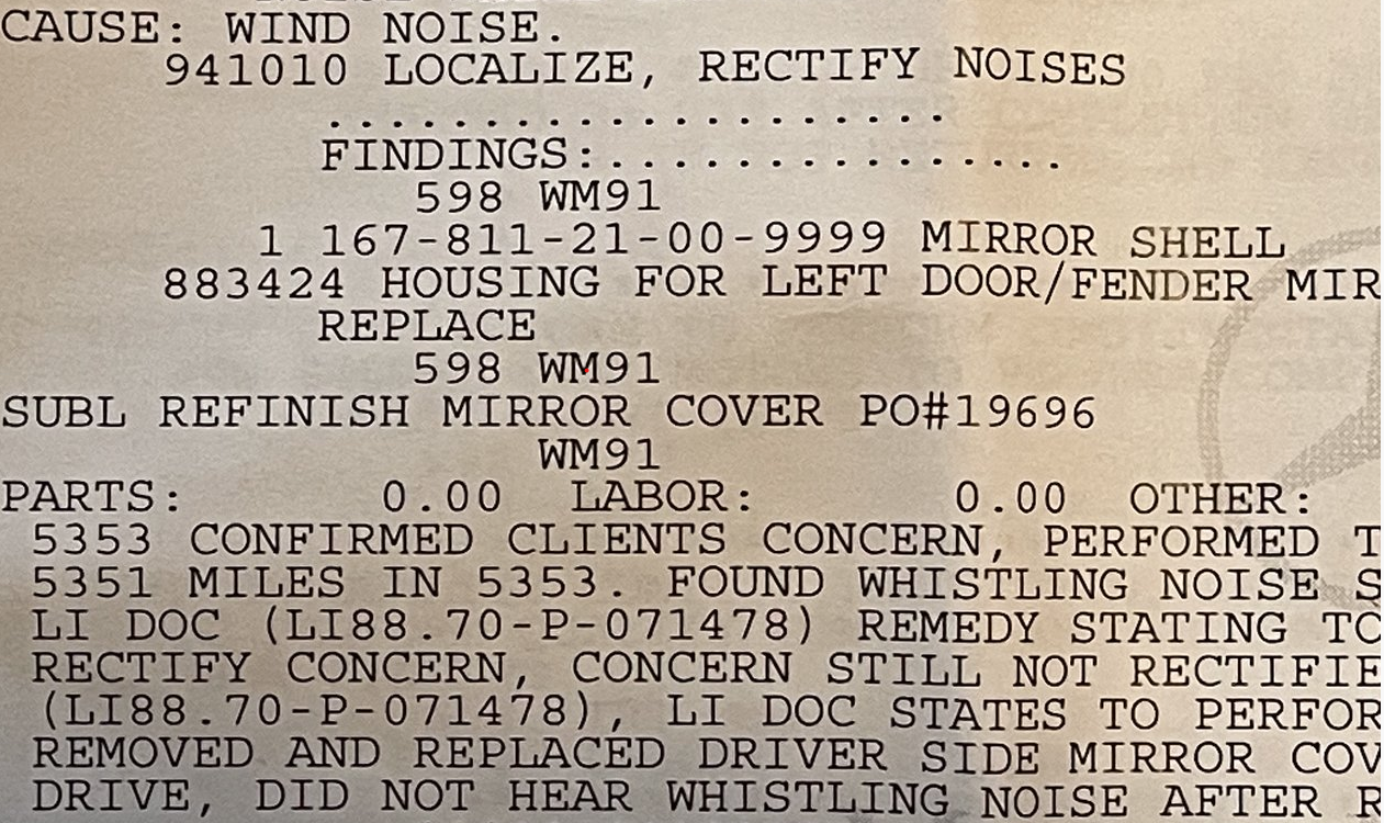

Can you confirm the part number of the replacement mirror cover? Is it the new design part number?

Dec 22, 2021 | 06:05 PM
This is what’s listed on the service order:
SPO 167 810 61 05 Mirror Shell

Dec 22, 2021 | 07:45 PM
The invoice for the individual (Daso) in the other thread that had his housing replaced is copied below. Looks like a different part number. Perhaps you had same faulty design part installed?
