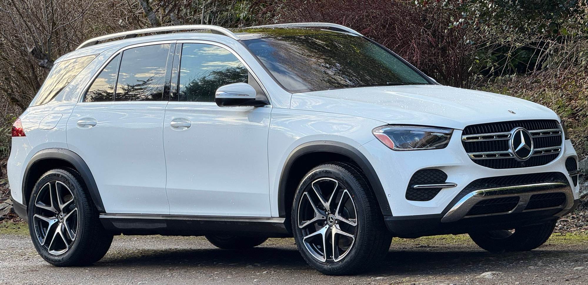

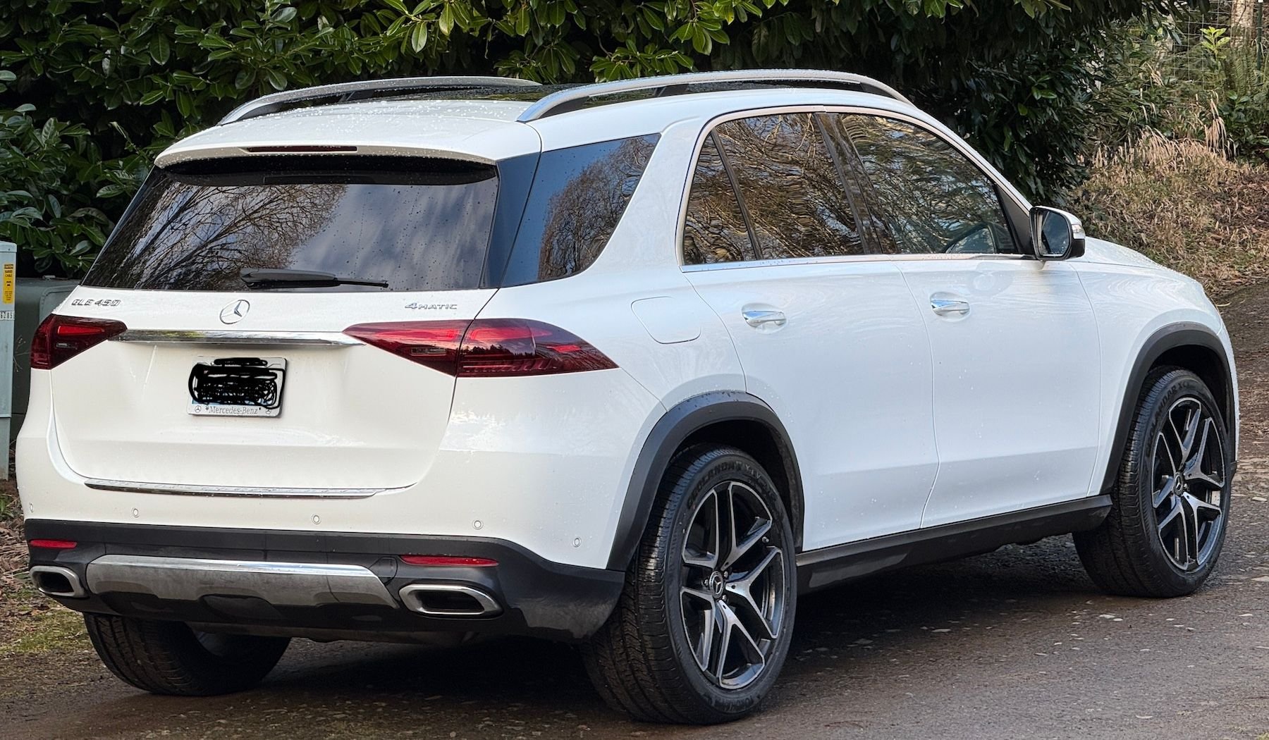

I know this thread is a bit old, but based on some recent posts, thought I would add my tire/wheel swap details.
Here are pictures of my car (non-AMG style GLE450), where I swapped from the standard 20s to 21s. I bought the replacement 21" rims from eBay, from another GLE owner, and added the tires/TPMS from Tirerack. The tires are Yokohama GeoLandar X-CV in the factory staggered 21" sizes.
I believe my fender flares are the more flared variety, which gives the new 21s a tucked-in look.
