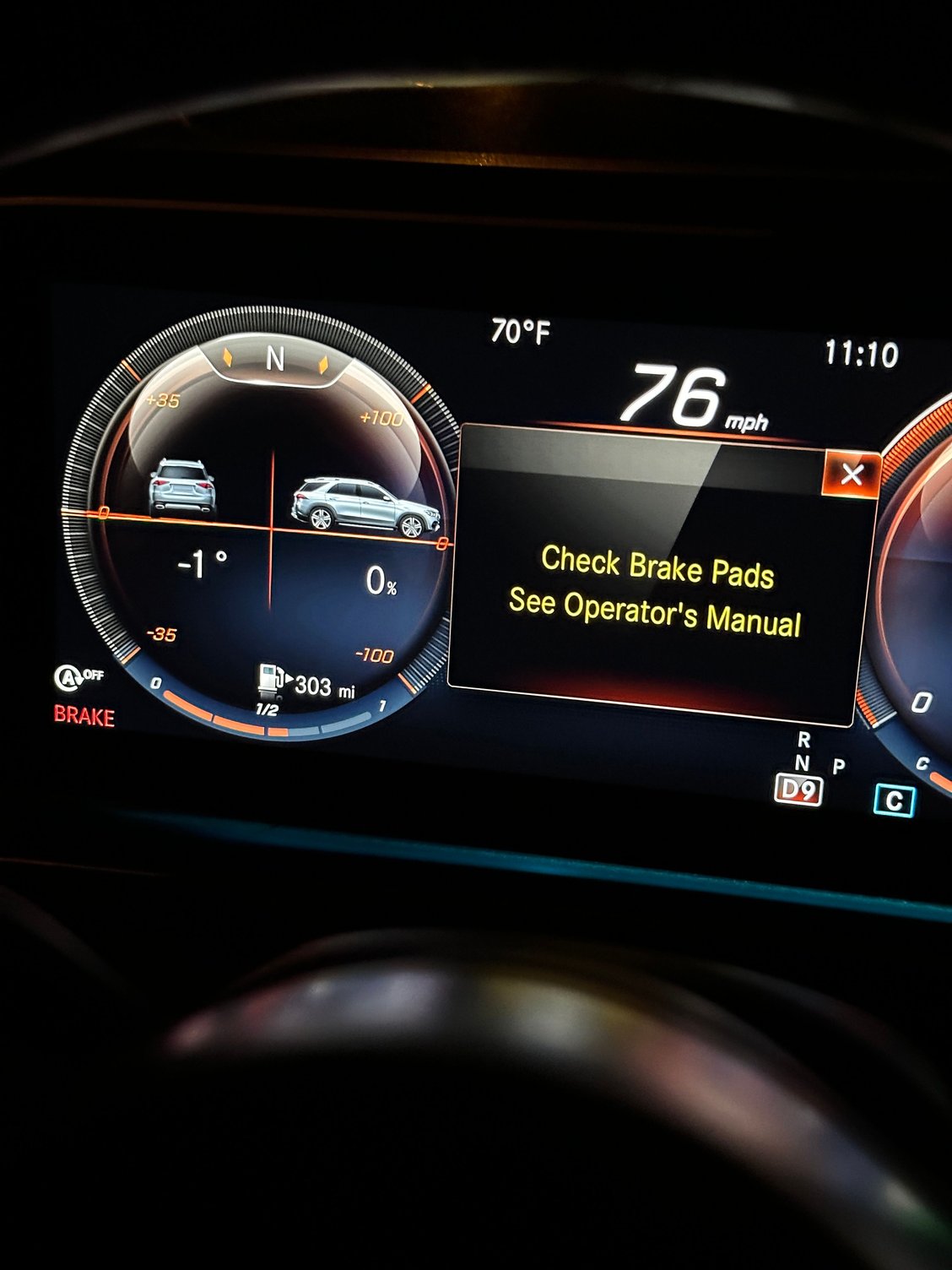

I was driving home from Sarasota and I received a warning “check brake pads, see operator’s manual” and the red BRAKE light showed up on the driver display while I was driving on the highway. Pics attached for reference. When I got off the highway, I pulled into Crown Eurocars because I happened to be there so I could check the manual to see what it says. The manual said to stop driving, however it was 11:30 at night and had no other way to get home, so I drove home carefully for 40ish minutes. I did not notice anything different when braking and I did not hear any brake squealing/screeching. Also I did not hear anything weird and my GLE drove like normal. I only have just under 26K miles on my GLE and when I got new tires a few weeks ago the SA said everything looked fine which makes me think I do not need new brake pads yet.
Anyone else have this experience? I was worried driving home because red warnings usually mean stop driving but this was red and amber colored. Also is the car still safe to drive? The dealership is supposed to pick up my GLE on the 30th to fix one of the tires they installed incorrectly and do some warranty work that I was going to have done either during my next service appointment in a few months or sooner. I am worried they won’t pick up my car now because of this and force me to drive all the way to Tampa to drop off my car (an hour away from me).

You can absolutely cook the pads in 26k
do you have pictures of the rotors to show what they look like? If you can get a close-in so I could see the pad thickness in relation to the backing plate it's attached to I can pretty much diagnose it from here.
You can drive the car down to the wear sensors and it might not squeal depending on how hard you brake, ironically if you skim the rotors barely itll squeal since there isn't enough material on the rotor to grab onto with along with other factors.

yeah i mean without photos you just gotta listen to the car. if you can see the pad it should be as thick as it's backing plate at the minimum, that warning means you have about 30% pad left

Update: It ended up being the front brake pad and rotors needed to be changed. The rotors were not warped, but I am still surprised I needed this at 26K miles.

I've noticed huge differences between Mercedes models, when it comes to how long I can go on brake pads. My W222 just needed new pads after approx 25k, but my last W166 was still running factory pads at 90k.
I just take it in, when the "Check Brake Pads" message comes on. Sometimes the dealership replaces only the pads (not rotors), and sometimes they do both.
I agree with your earlier comment about anxiety with a RED warning light, as those of us who've driven Mercedes for decades are trained that a YELLOW light/message means you can keep driving, but a RED light/message is more urgent. My hunch as to why the red "BRAKE" dash light remains constantly illuminated (until the pads are changed) is that Mercedes knows we will clear the "Check Brake Pads" message from our display, and they really don't want us to forget.
