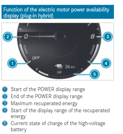

Yes, it works in all modes, including "Battery Level".
You can see it working on the dash if you select the tachometer display, like so:
The "CHARGE" bar indicates the amount of regen that is being applied.
