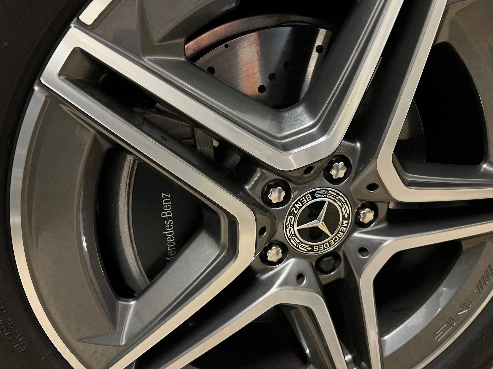

No, my GLE has those calipers which are a cheaper 2 piston sliding caliper.

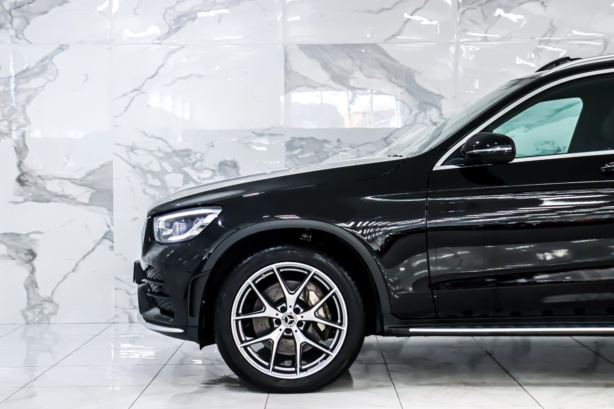

What I mean is a lot of the Mercedes cars from 'lower' in the model range use a nicer looking 4 piston fixed caliper, which isn't the full on 6 piston AMG unit but still looks nice.
I wondered if there was any cross compatibility between the models which would allow one of these types of caliper to be fitted to the W167 GLE without going for the full hog AMG 6 pots.
Example of a 4 piston caliper from a GLC 220d below:
