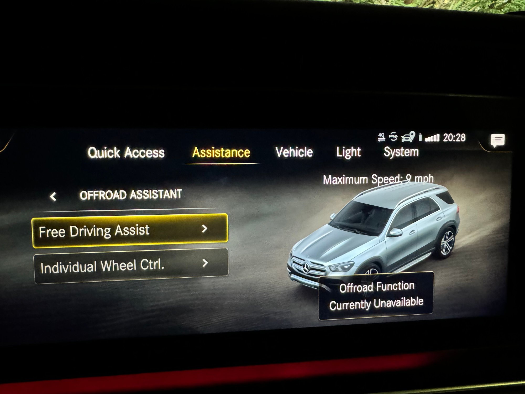

2020 GLE450 has an off road package, ie air and Hydraulics. It was bouncing fine about 6 months ago and today on the beach it would not do it. Screen is showing “off road assistance unavailable”. Maybe I was doing wrong then last time (6 months ago) but vehicle was in “drive” mode, “off road” dynamics and my foot was on brake pedal. No malfunction messages as well. Please help to make my baby bounce again. Thank you!

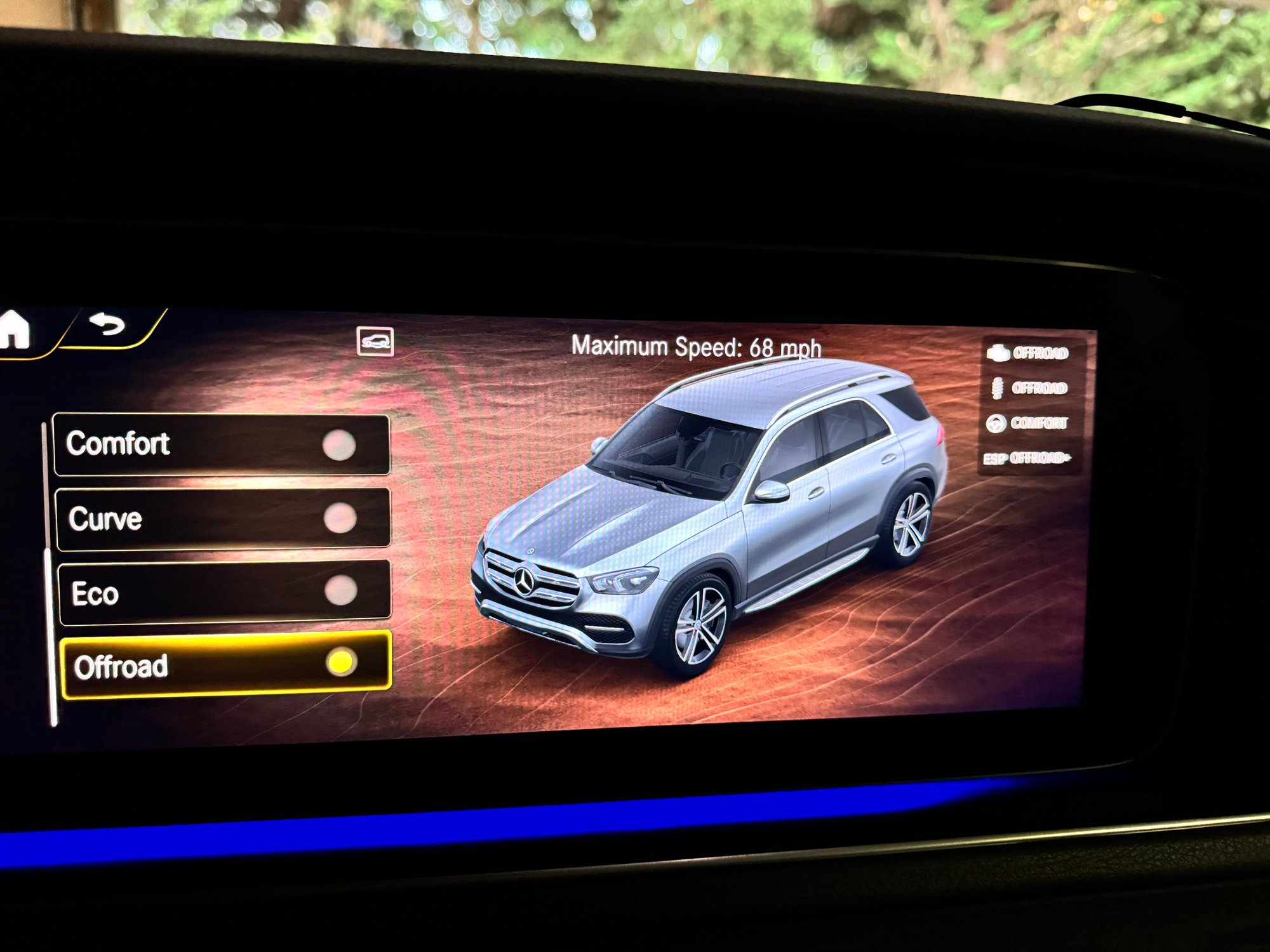

I looked again and noticed that in dynamics “off road “ shows everything in off road mode, except steering in comfort and ESP is in off road+ (never saw off road + in the past). Please see attached photos. Thank you!

Off road still not working and navigation started showing vehicles location in Germany alone with tons of “not working” dash messages. Took it to the dealership and after several times MBUX update failure they replaced MBUX. Now everything is working, CPO covered the repair. Thank you all for your help!
