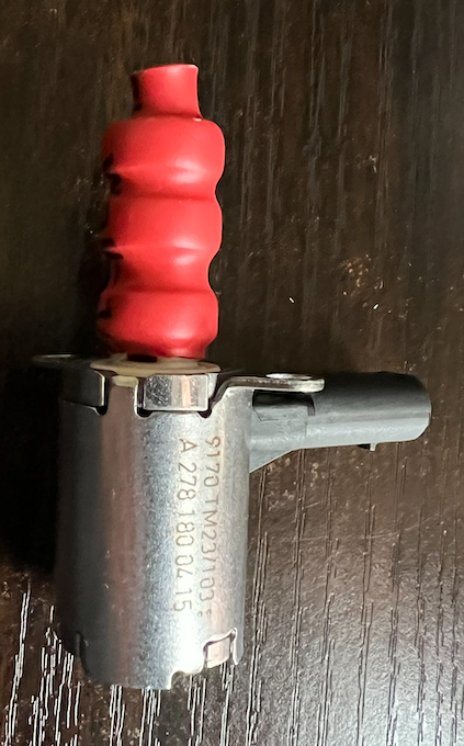

HOLY COW!!! Read this thread: https://mbworld.org/forums/w212-amg/...solenoids.html
The conclusion is to ignore it (per Mercedes instructions). If the CEL bothers you (it would me), buy the part and connect it externally to the cable harness. All the info you need is in the thread.

The red heat shrink was added since the part sits on the front of the engine.

P06DA00 is a code set for a malfunctioning oil pump solenoid whose sole purpose is to artificially restrict oil pressure (and oil flow) in the interest of reducing the energy it takes to circulate oil and therefore save miniscule gas mileage. It's all in the thread I posted above.

OK, attaching the decoy solenoid to the wiring harness will tell the ECU it has a working solenoid. The DTC can be cleared and the CEL will turn off so you can pass inspection.

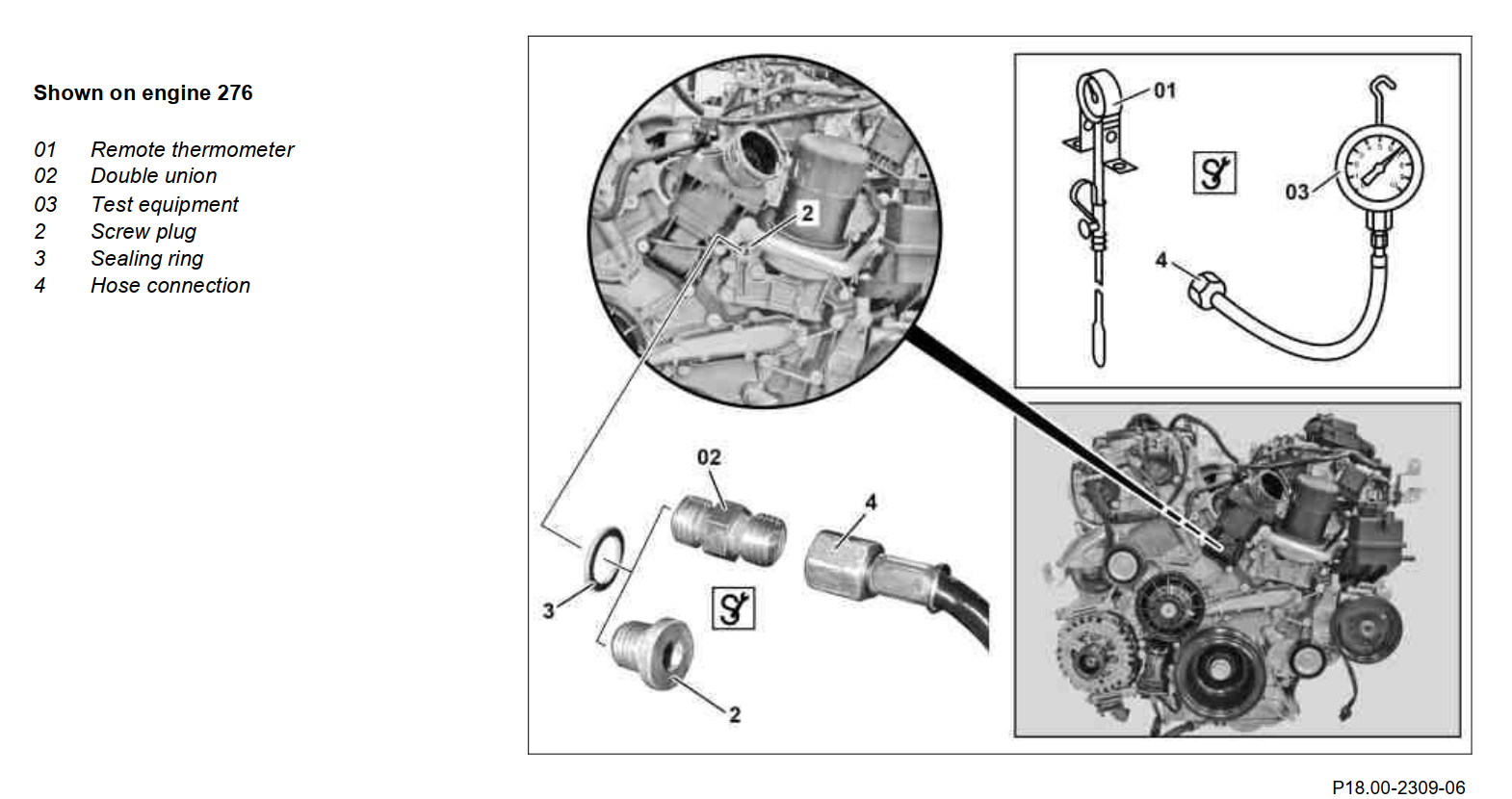

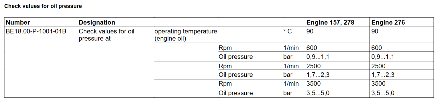

One way to check is to connect a pressure gauge to the oil diagnostic port IF his engine has one. On the M276 it is right next to the oil filter housing. If the pressure is above 2 bar at less than 3500 rpm, the solenoid is not stuck. If the pressure remains less than 2 bar at 4000 rpm, then it is stuck in the wrong position.

Old Oct 17, 2024 | 04:00 PM
JettaRed's Avatar
Veteran: Army
iTrader: (1)
Joined: Nov 2016
Posts: 7,847
Likes: 3,496
From: Maryland
File Type: pdf
https://cimg6.ibsrv.net/gimg/www.mbworld.org-vbulletin/1570x830/image_d27718b21a42d4dabcf0aeaddce36ab5fcf2dfcd.png
https://cimg1.ibsrv.net/gimg/www.mbw...e07456d900.png
Perfect! That is a good idea : )
Hopefully OP gets that test done, once OP is done with it, confirms pressure good, just unplug it, to OP's benefit after all.

I see but basically all you needed to do is instead of "fixing" it, plug a dummy solenoid in the existing connector outside of the vehicle and enjoy the benefits not having it brings. That said, since you already carried out the repair, don't want to rain on your parade, enjoy the car.
