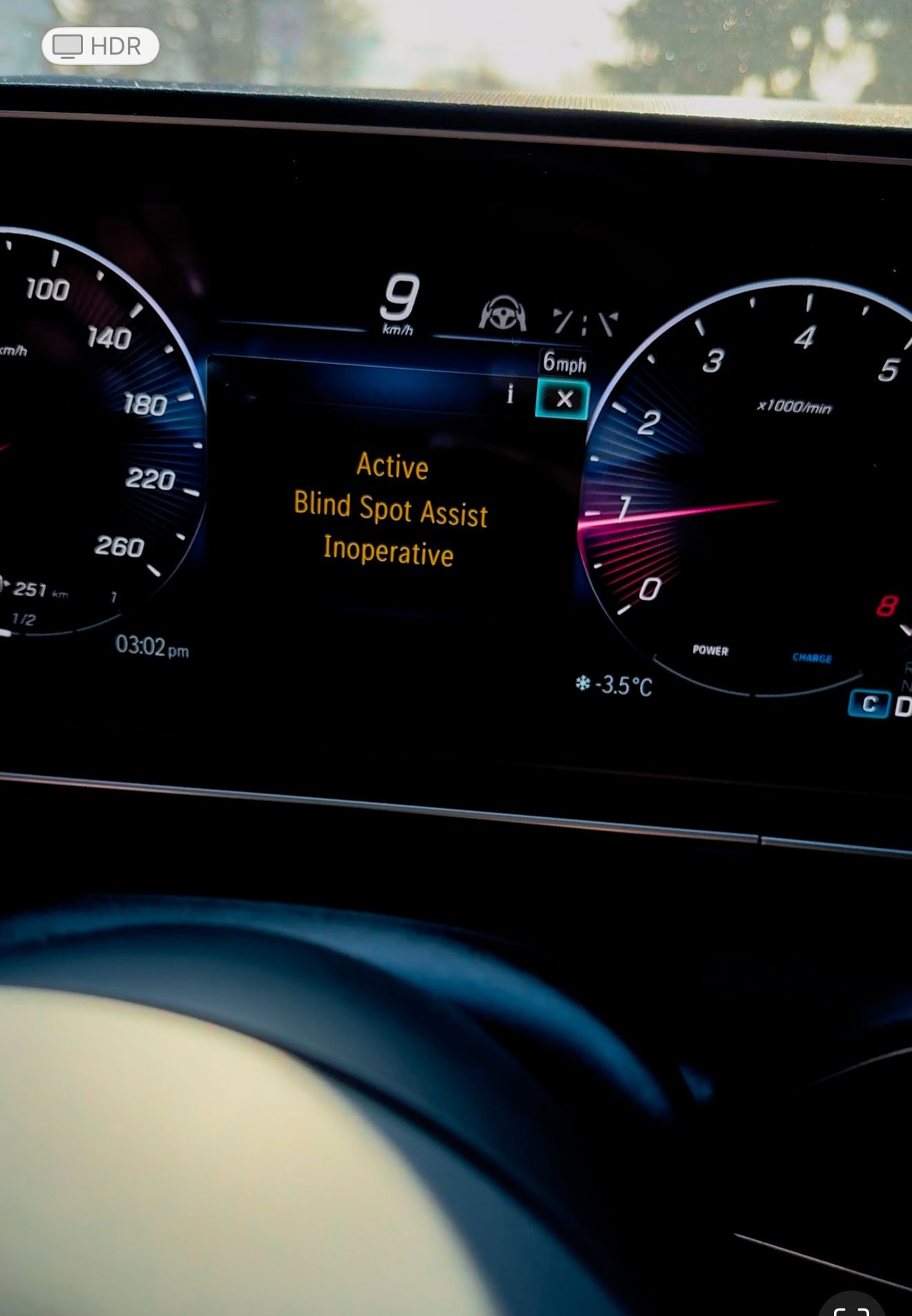

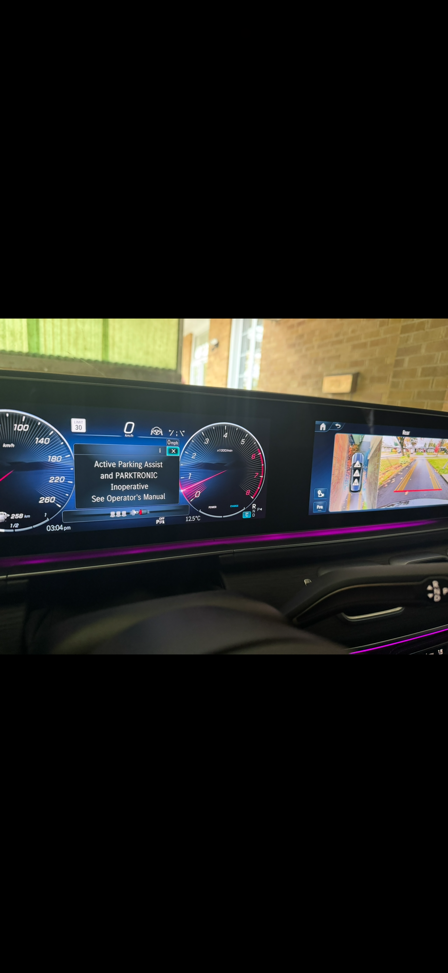

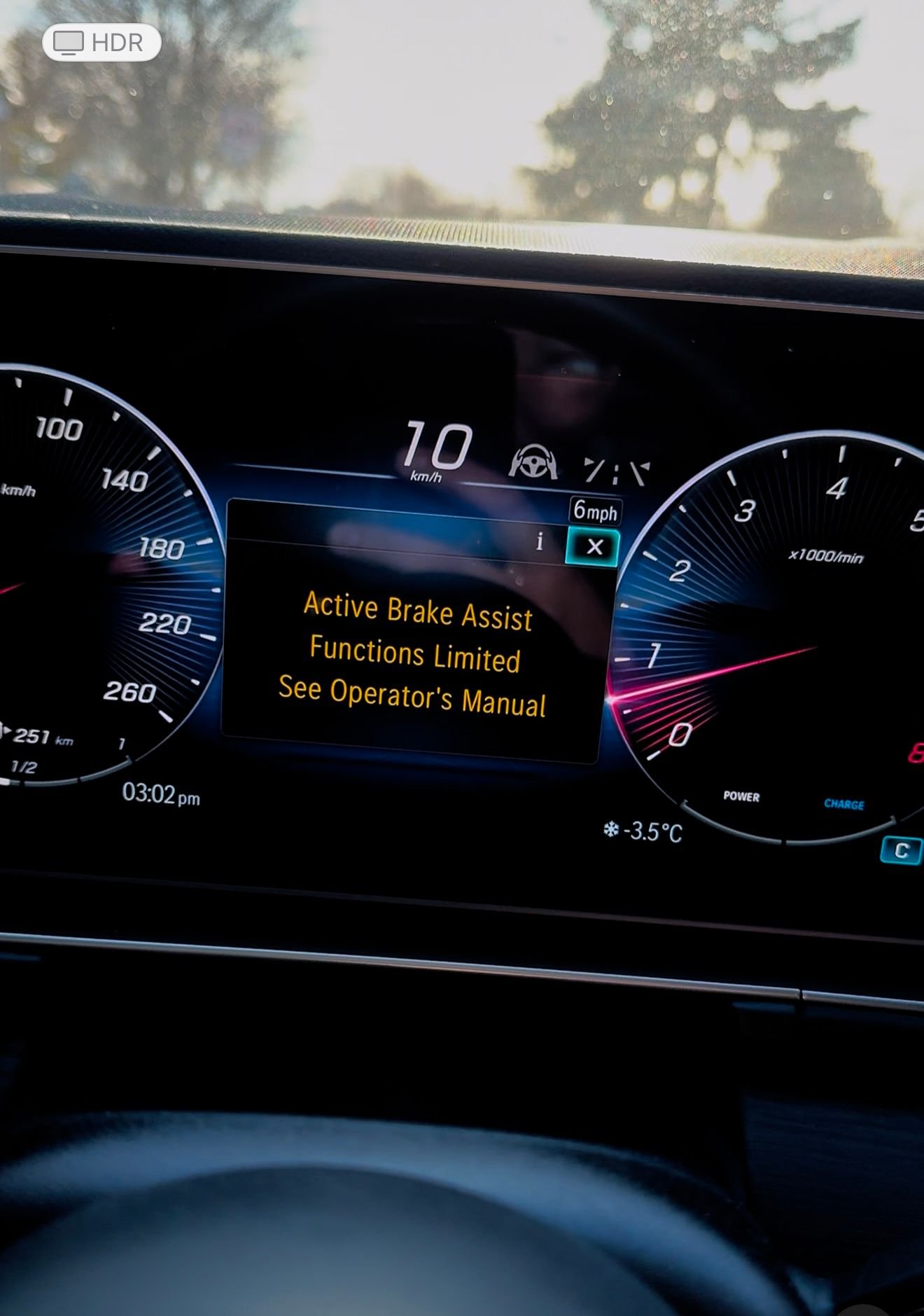

Hi fellow GLE owners.
About 50% of the time when I start my car and shift into Drive or Reverse I get these warnings. It’s really annoying and quite embarrassing when others are in the car.
Once I start driving it goes away and all systems appear to work normally. Sometimes however I’ll get these inoperative warnings while I’m driving.
I’ve taken my car to the dealer 3 times for this and they always just do a “software update”, it clears up the issue for about a week but then it all comes back.
Has anyone experienced this and did they find a fix? Appreciate any help thank you.

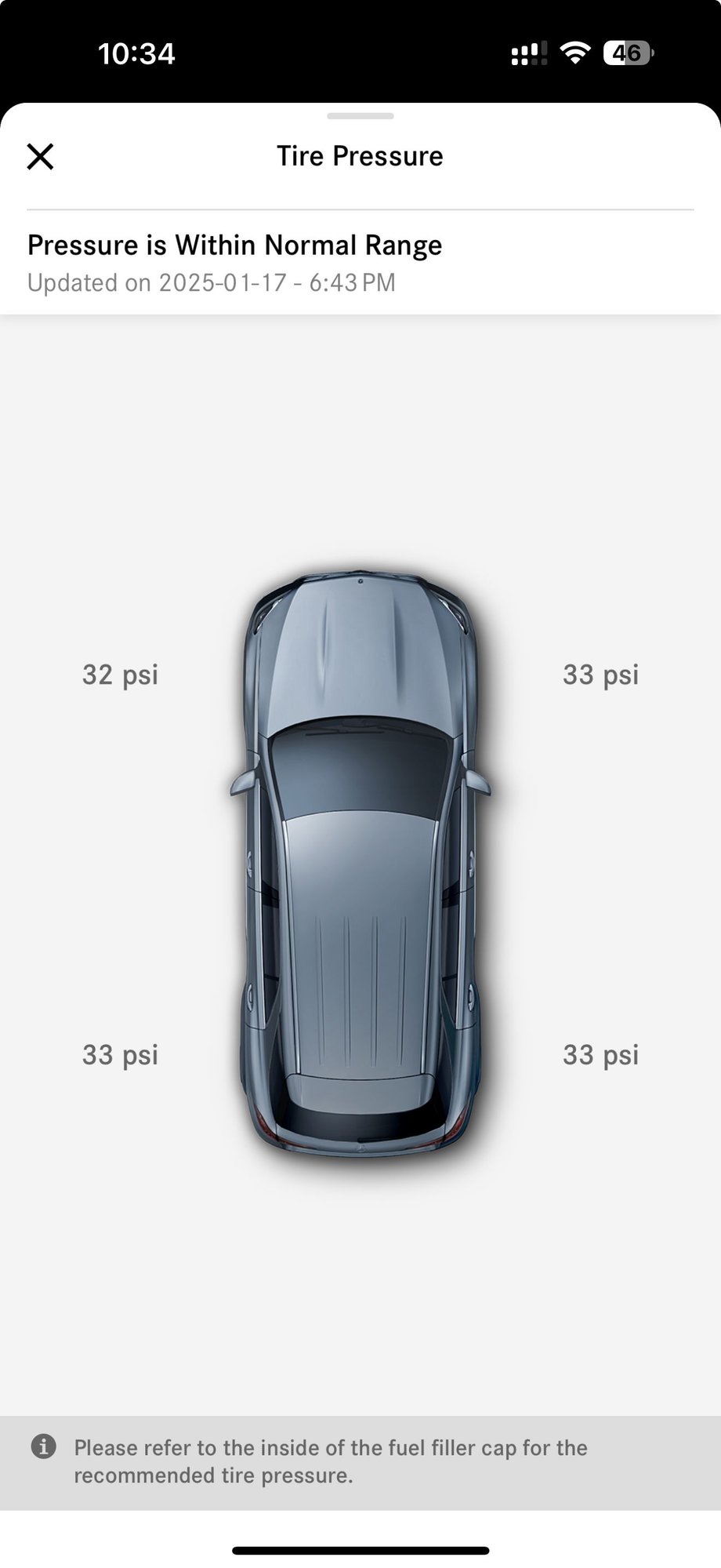

Might be a tire pressure issue: https://mbworld.org/forums/s-class-w...down-help.html
Reply 0
Jan 18, 2025 | 10:36 AM
Interesting, thanks for sharing. My tire pressure is within normal range but it’s been really cold where I live in Canada. I’ll try topping them up a little bit and see what happens.
Reply 0
Jan 18, 2025 | 10:41 AM
Quote: Interesting, thanks for sharing. My tire pressure is within normal range but it’s been really cold where I live in Canada. I’ll try topping them up a little bit and see what happens.
You're welcome : )
Hopefully that fixes it, might explain why after driving the issue fix itself but after sitting overnight, the first drive, the error messages comes back up as you know, driving increases the tire pressure as air heats up.
Use the cold tire pressures listed on the fuel cap, if you have winter tires, use the M+S values.
Once done press ok on the tire pressure screen and select accept as new reference values.

Just sharing an update, I’ve topped up my tire pressure and reset values on the system and haven’t had the error message pop up again. Hopefully this was the fix, thanks for all the help!
