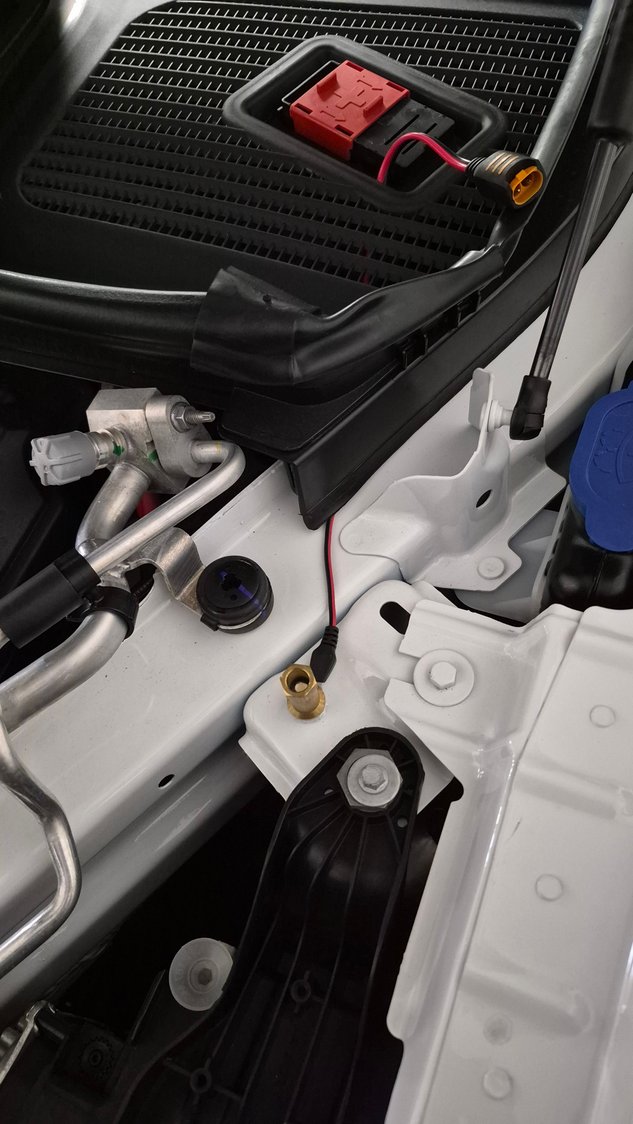

Old Feb 25, 2026 | 07:15 AM
fun33's Avatar
Joined: Oct 2018
Posts: 380
Likes: 100
From: Orlando, FL
2017 550SL - 2018 560S
With my setup, as shown in the photo, I connect another 8-foot-long CTEK cable to the permanently mounted cable the dealer installed. I can charge with the hood up or down; it makes no difference.
An extension cable works well, especially with a wall mount battery maintainer such as the Noco 1A unit. I avoid running an AC power cord under the hood where it might get pinched.
