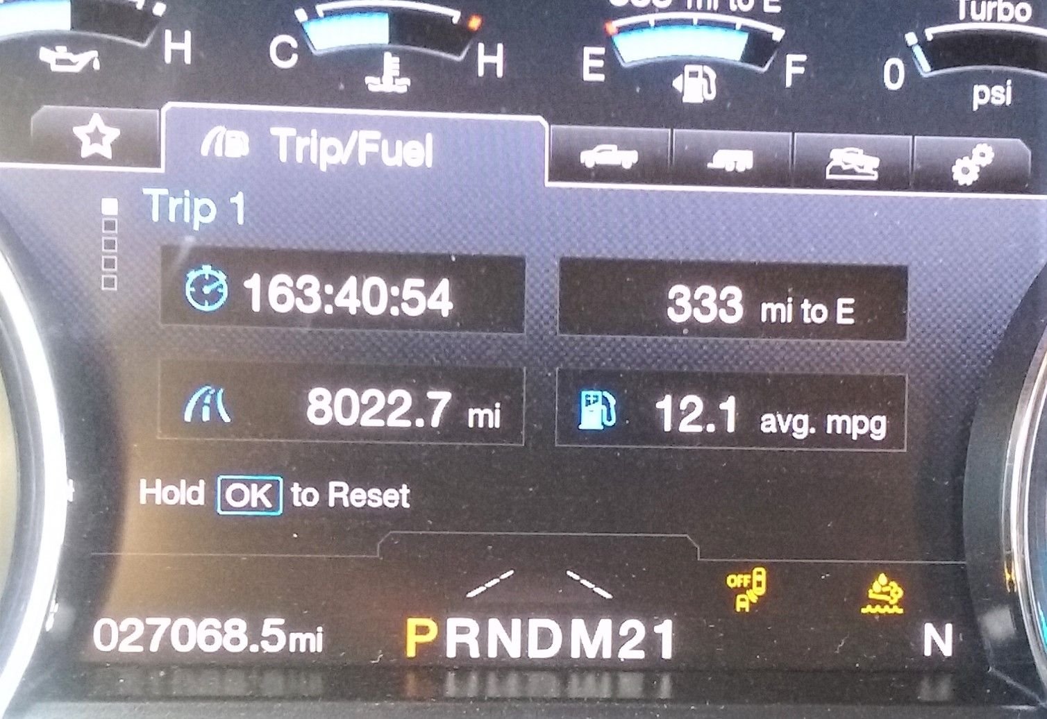

This is summary of our 2019 vacations.
I drove truck with camper at 60 mph.
Sure took retirement to have time for it.
