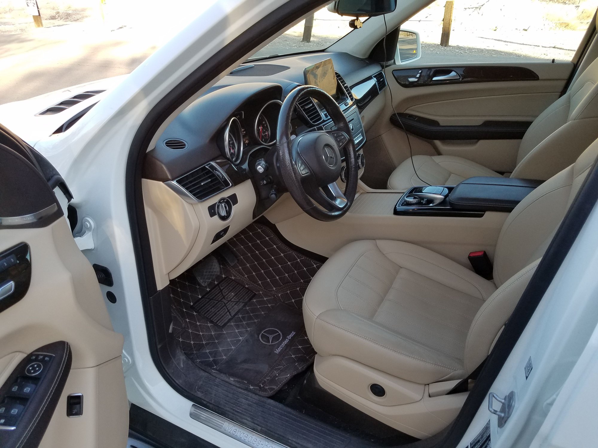

I am biased to liking white/tan interiors.
Some GLE have them really beautiful and when I could not find white with the engine I wanted, I found light tan. Added custom carpets to it and each time I open the door showing it to new person, I am getting "WOW" as response.
Did not see such interiors on ML. Maybe my bad luck, maybe they are only GLE mounted?
