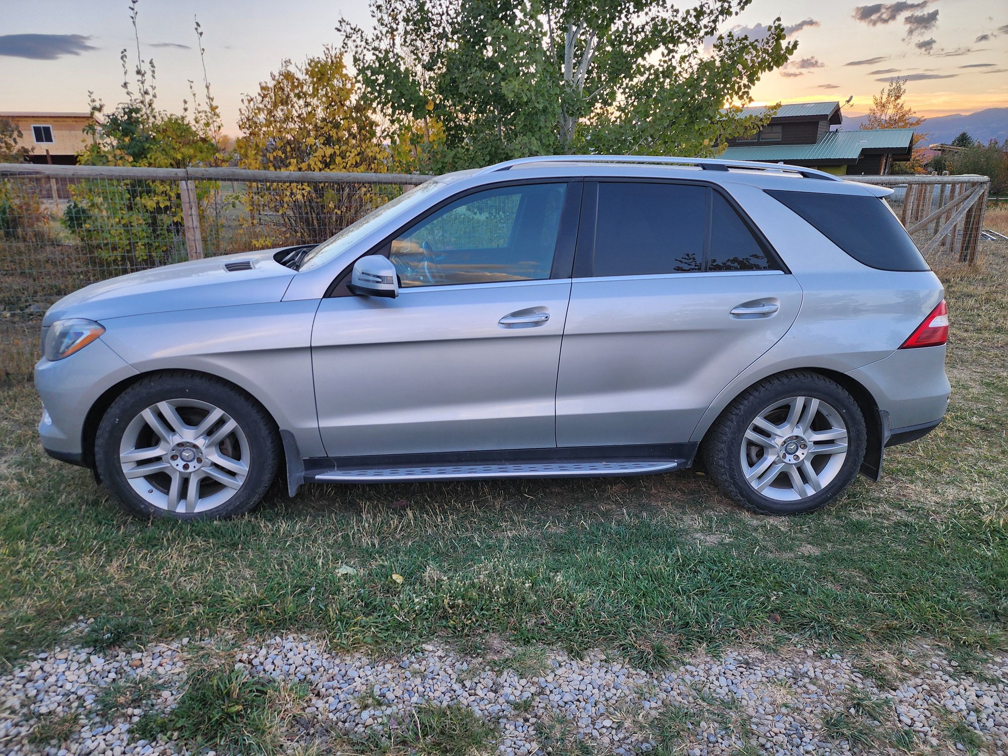

Appreciate the response, I know it’s a bit of an ask but do you mind posting photos of the wheels/rim so I can see the wheels sidewall with that size on the W166?

I will take a few photos, but it might be a day or three before I can. The wheels/tires fill the fender nicely without being too big.

Here you go:
