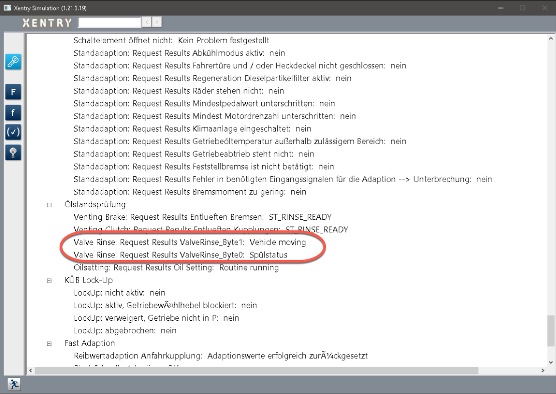

I think the "valve bleeding" may only be with the 9G tranny. Below are variables that can be set when using the XENTRY Simulation. This was for the 9G transmission.

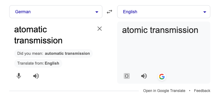

Originally Posted by ygmn
what is a ATOMATIC transmission?
see title of video above.
According to Google Translate, it is an atomic transmission.
