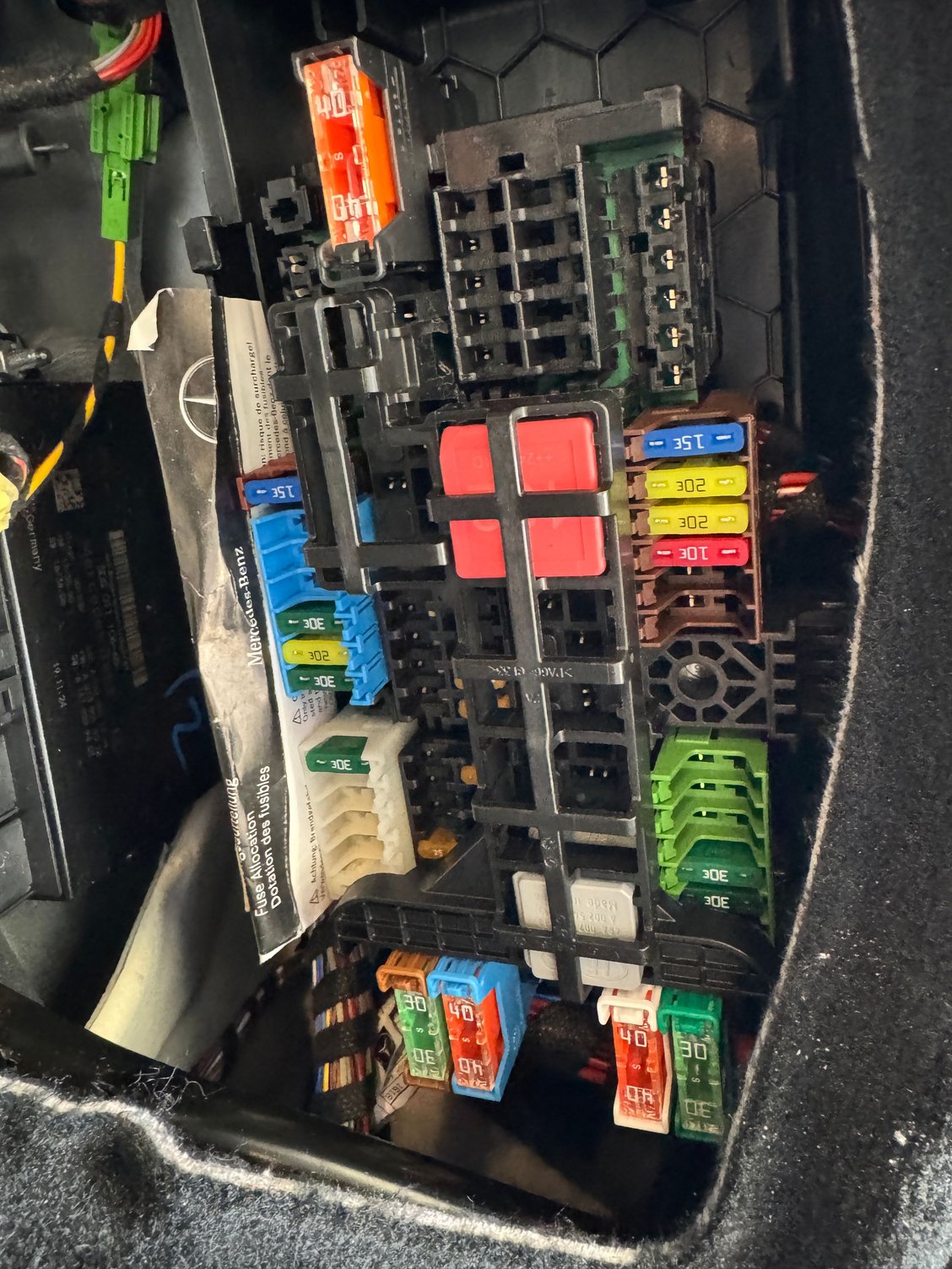

My ambient light is only working in driver side. I want to get to the 417 fuse in cargo area but it has this plastic cage over the fuse box blocking the fuse. How do you remove it?
I’ve tried a flat blade screw driver but to no avail. Stupid design.

The smaller fuses in you pic have retention tabs that simply push to the side to clear the fuse. The retention tab on the big fuse is different?

im talking about removing the cage surrounding the fuses. You can’t get to the ones at bottom with this cage in the way

I think those are relays under the cage you've circled.
Agree, looks like relays to me.

Checked my fuse blocks, but none of them use a captive cage like that one.

I'm looking at the manual. From the photo I see interior fabric. There is a fuse box is in the cargo compartment on the right side,
fuse box on the driver side of the cockpit and fuse box in the front passenger footwell.
I would pull the F417 which is a 7.5 amp brown fuse well hidden in the trunk panel. You need to remove the piggy back fuse holder to access it. pull the fuse out for about 15 seconds or so, and re-installed the same fuse if it's not blown if it's blown replace the fuse, to see if it's working. If not working take it to the dealer and have the software updated. Should be under warranty.

how do I remove the piggy back fuse holder? I can’t figure that part out. Thank you.

If you can unfasten the entire fuse/relay block and flip it over, there might be release tabs on the backside. Just curious -- why do you need to access the relays?

I can’t get to that 417 fuse because the cage is in the way unless I’m missing something.

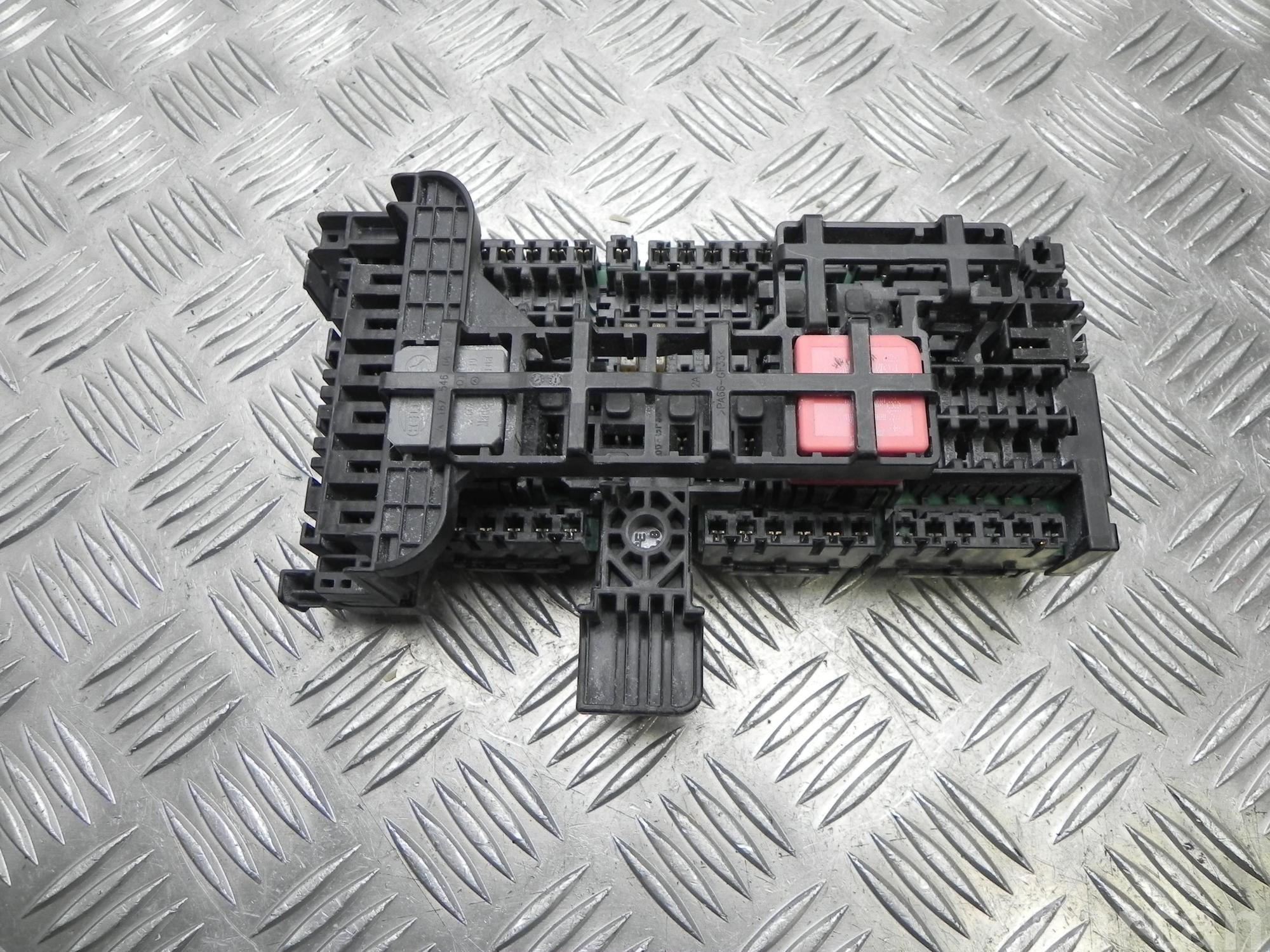

The part number is A1679063103. I'm looking at photo's on the net. It maybe held by tabs. Let me research it more. If not I see if my sister can give me the keys to her husband 2025 GLE350 and I can do a quick peak without him knowing when I can get a chance.

thank you. I couldn’t see from the parts photo how it is held on. Let me know what you find out.

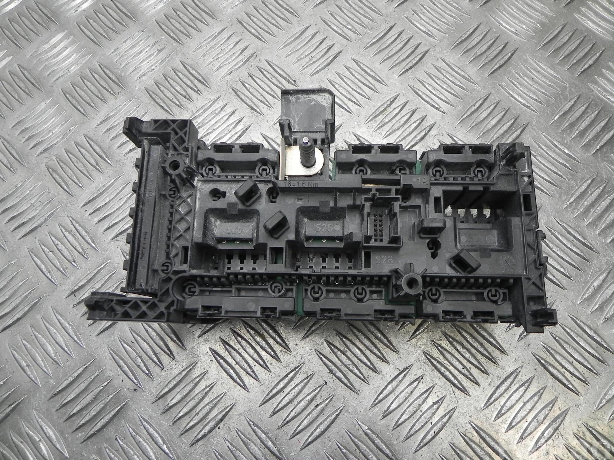

I'm still trying to figure it out I found some close up photos
Front view
Front view
Back view
Back view
Fuse Cage Remove
Fuse Cage Remove
