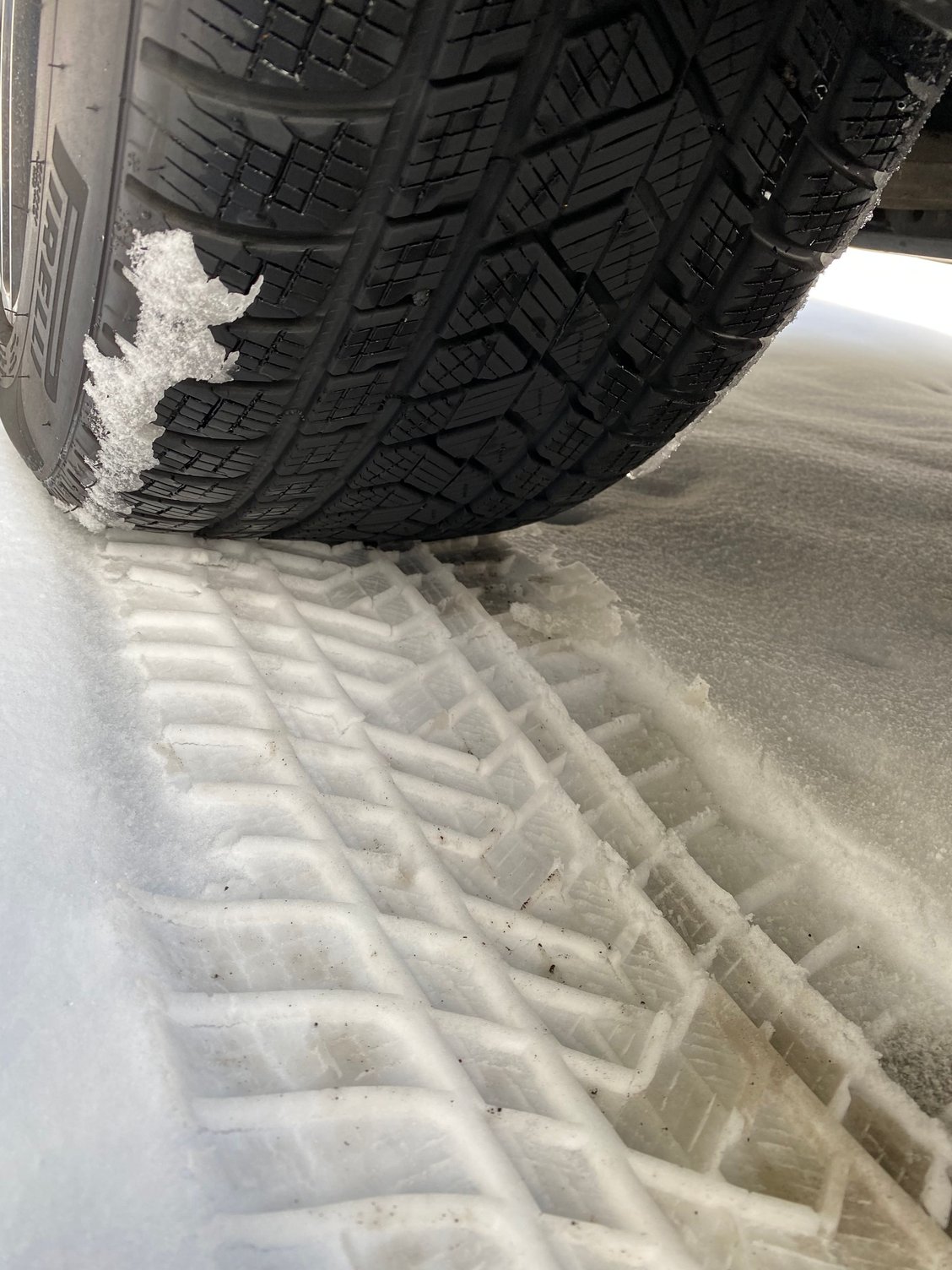

I took this photo just today on my 21” wheel.
Snow
I used this Pirelli Scorpion Winter tire now for two years. Last year was through deep snow. not one single issue.
