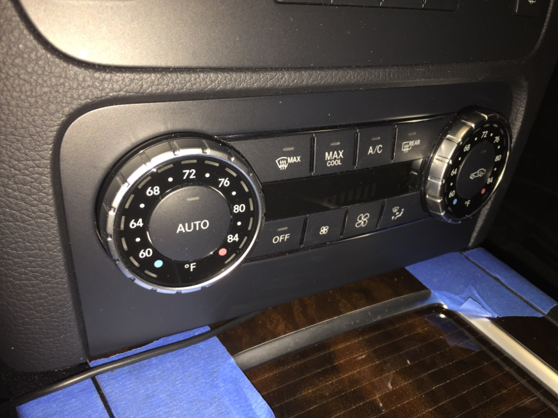

I have looked at all data and in another forum where I'm also a member there is a sticky for removal of the console but no pics. Since I have limited pic access there vs here this are the pic instructions.
http://www.benzworld.org/forums/show....php?t=1997121
Remove cover
Attached Thumbnails Removal of console cover for 2013 and up GLK-image-891408112.jpg

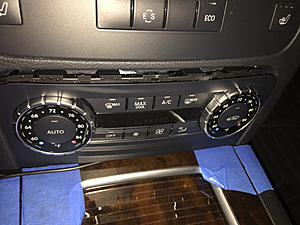

Start with fingers in the center part then use a screw driver
Attached Thumbnails Removal of console cover for 2013 and up GLK-image-2947445965.jpg

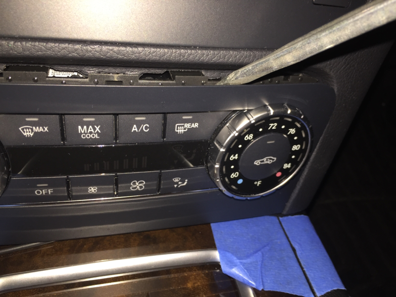

Remove the console cover gently. Didn't want to crack or mess up the leather trim hence put masking tape and used a butter knife to pry it open then a wide screwdriver to help pop it out.
Attached Thumbnails Removal of console cover for 2013 and up GLK-image-2909238677.jpg

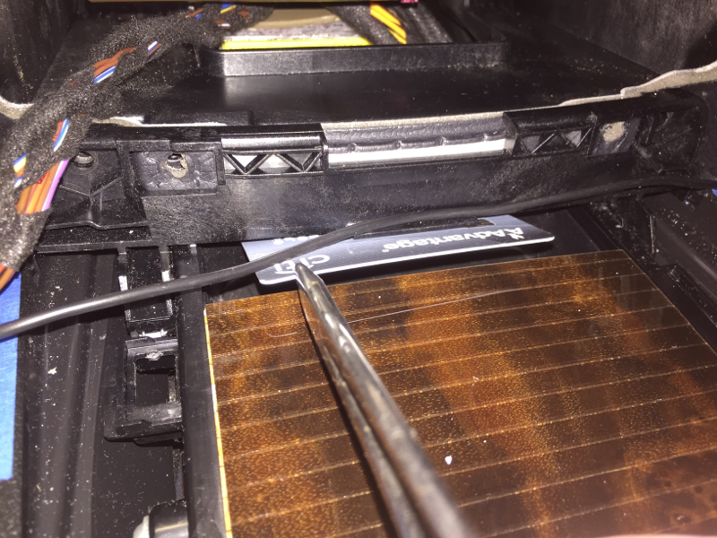

Now get whatever dropped in there from the back. Use a sticky tool or a forcep to gently get it out. As for me. An AA credit card
Attached Thumbnails Removal of console cover for 2013 and up GLK-image-1448467957.jpg
