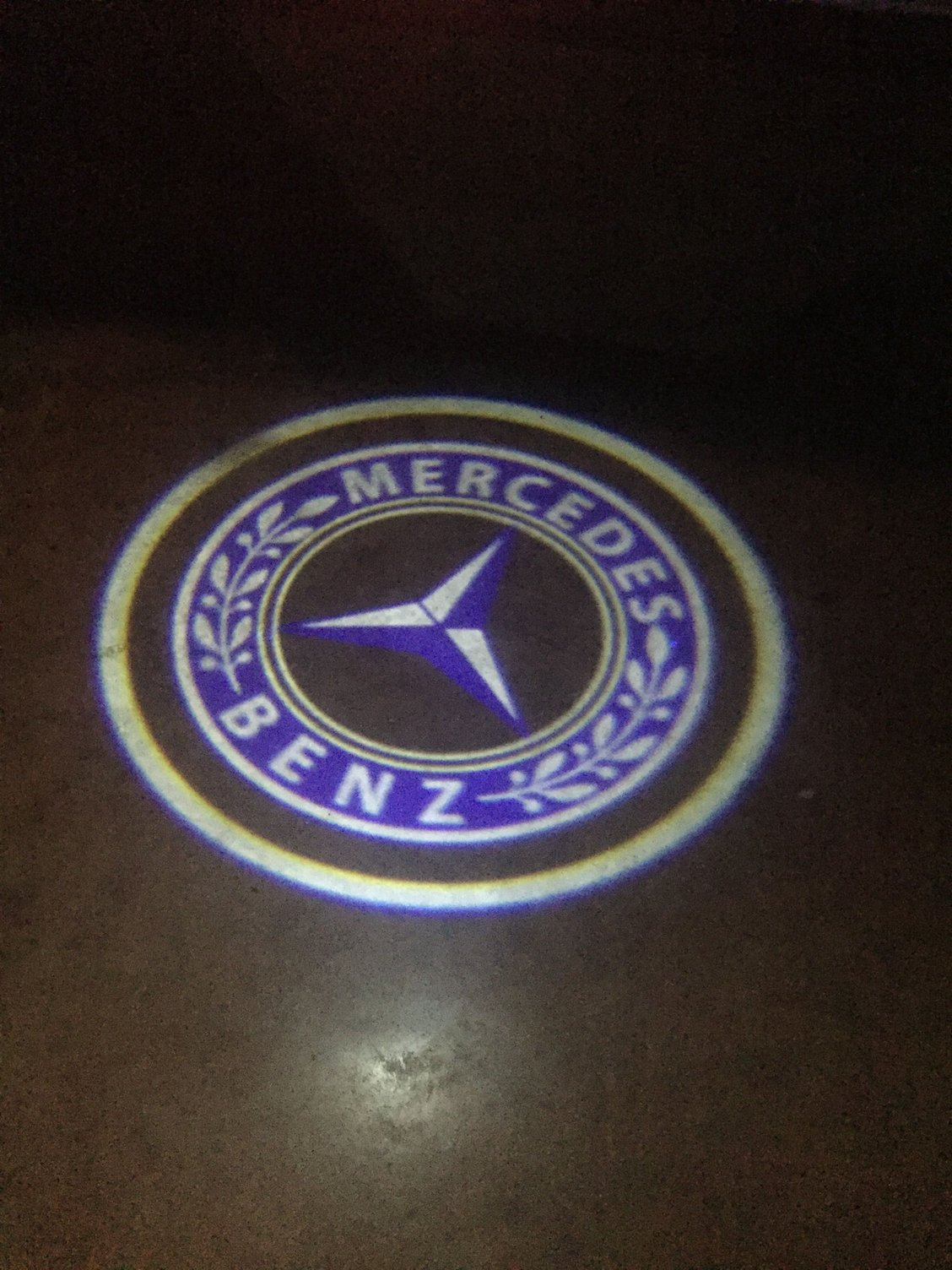

Hello everyone,
I am new here but wanted everyone to know how I wired in welcome door lights on my 2013 GLK that only had reflectors in the doors. I tipped down the console that houses the interior light. See the picture
Once you tip down the console turn the light sockets a quarter turn and remove the socket and solder the wires on the side and then
snaked the wires towards the windows (remove the sunshade courtesy light) that makes it much easier. You will need to flex the trip that runs along the interior windows down the door. Next sneak a wire inside the door through the door conduit into the foot floor area on both sides of the SUV.
The door wires can be run by removing the part of the door that pops out (horizontal) from the door window switch. See the second and third picture
