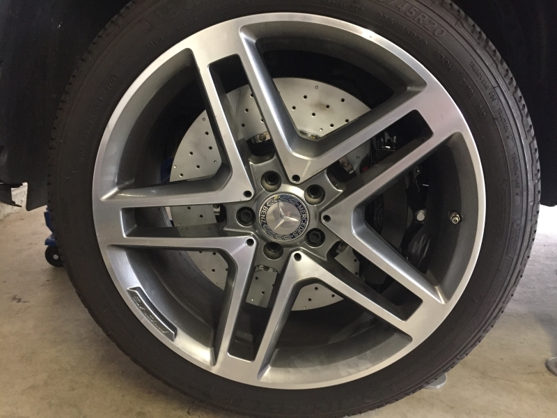

I did it, sweet install, calipers from AMG E55 (8pot, huge and heavy) w/ front 360 mm rotors from any AMG C/E/CLS, etc, rears rotors must come from E/CLS to ensure they will fit (180mm diam) GLK's parking brakes);

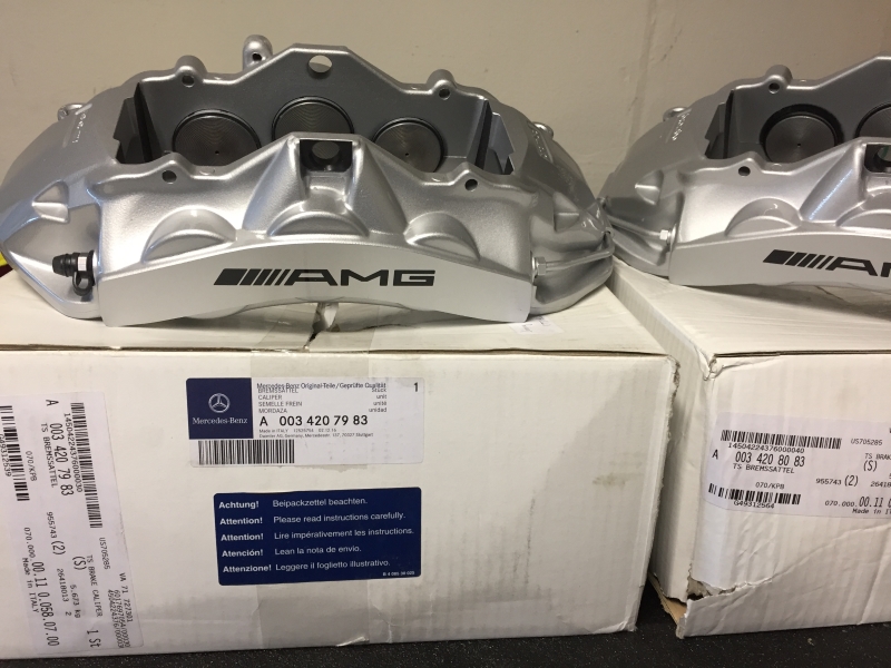

W211 E55 AMG, W212 E63, and C219 CLS63 (ones I got) will fit on the steering knuckle. The brackets match to the 110mm spacing. You can not just get bigger calipers up front, you will need to buy fixed 4 pistons in rear as well. The dust shields need to be removed or cut. The type of wheels you have will be the last fitment.
Since I have the bigger 390mm rotors, all sizes under will fit (380mm & 360).

Yes, all calipers (from an E55) fitted w/o any issues, rotors are the ones I posted pics above - brake lines/hoses must be replaced, the original ones from the GLK do not fit the AMG/Brembo calipers, so thats the toughest work and, GLK's front dust shields must be removed or cut, rears can be kept w/o any cutting;

Sorry haven't updated my end for a while, been busy with stuff. I finally got my calipers back from powder coating and they look decent for me.
But if you have a 4matic variant, the AMG front brake caliper will not connect to the line. You have to utilize a Brembo Racing GT caliper with a banjo bolt set up.
I ended up going with cheaper Brembo pads that are advertised to abate dust better. Everything fits in my build so for except the front brake lines & dust shields as Djorge pointed out. I am still waiting on my hubs to get coated and some titanium bleeder valves from England.

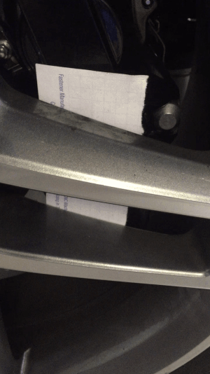

Clearance on my 20" wheels is tight with on 0.1mm (.004") of space. My 19" still fit with lots of room.

Hey there, please allow me: since you spent well to paint those calipers as they deserve, be prepared for your rims to naturally hit and scratch them so, better consider increasing that clearance w/ hub centric spacers with longer bolts - trust me, regardless if you have original rims (more torsion) or replicas (stiffer and weaker alloy) rims, that happens during highway turns....

I will be using my 19" wheels as is (they don't hit); 20" will be getting 2 or 3mm spacers.
