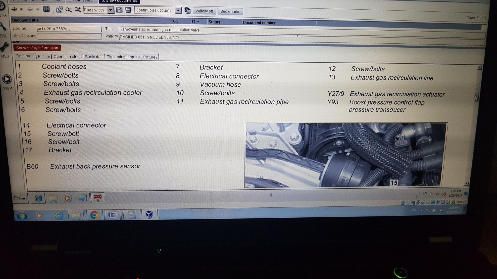

The video in the earlier posts tells you how to take out the easy part. Then at 45 seconds it skips passed the hard part and magically removes the manifold ... I tried to remove the EGR Cooler but looked to complicated without an actual manual. Can anyone point me in the right direction? Thanks!

GLK250 ML350
I purchased the repair manual, which part you need help ? I can try to download the pictures and posed in here, or I can give u a link to pay $30 to download the manual

I need help removing the EGR component. If you can share that would be great. I would purchase the manual but after this repair it's going back up for sale. This vehicle has been nothing but problems for me. I like the way it looks and drives but i'm over it lol. Thanks!

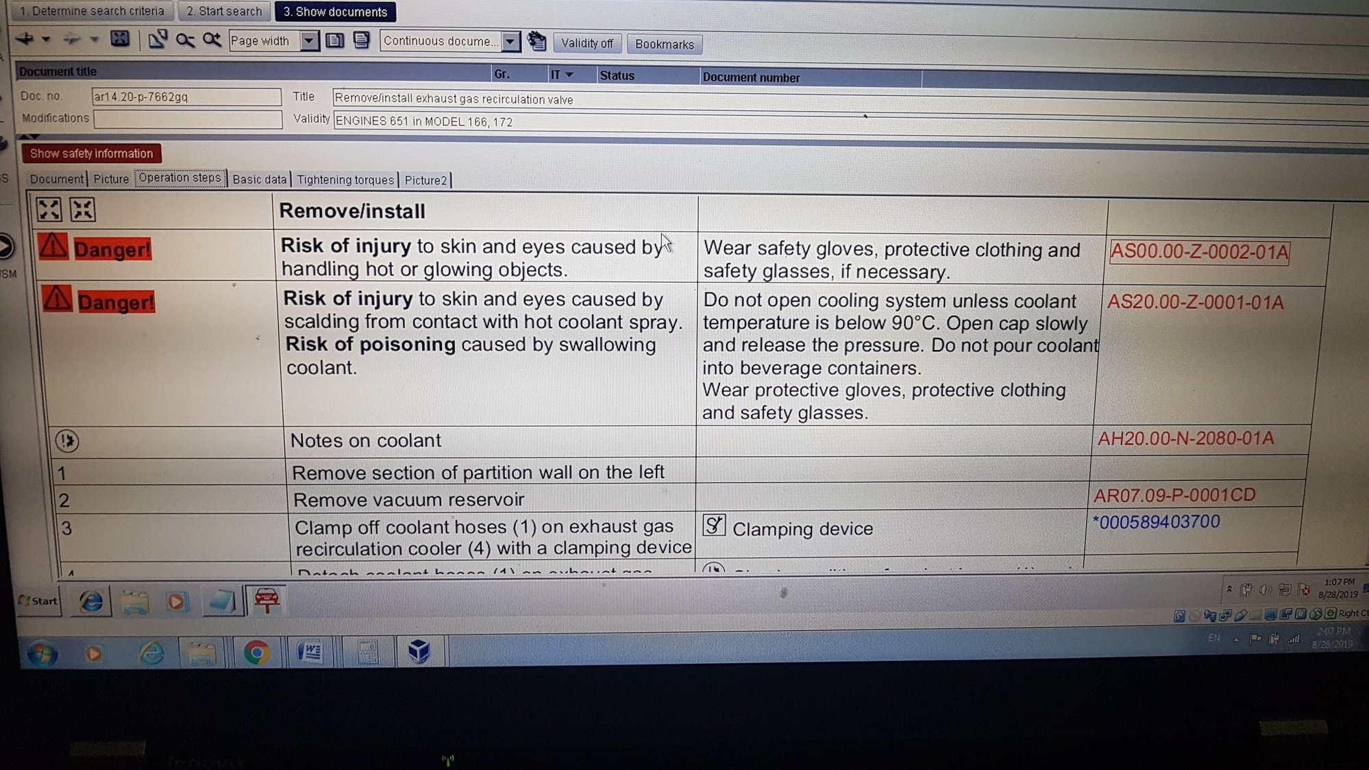

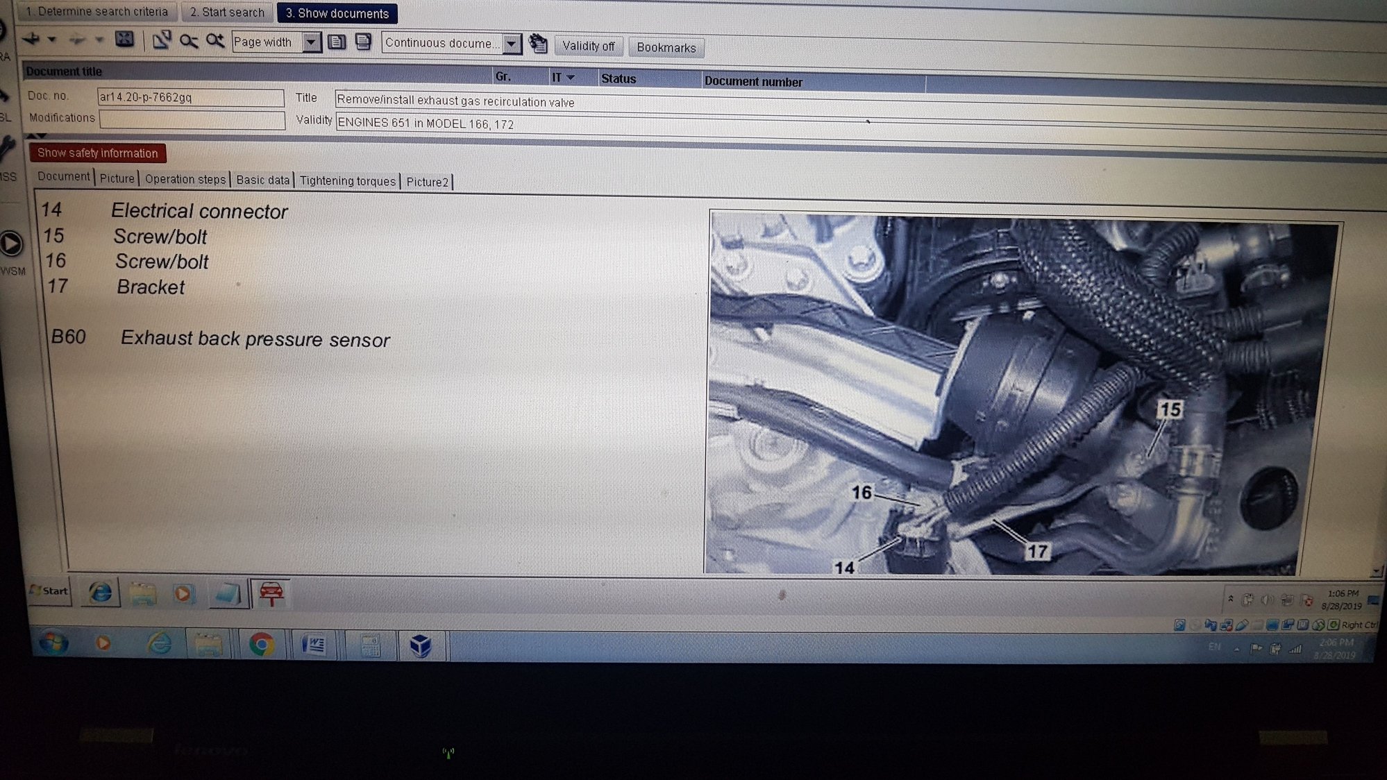

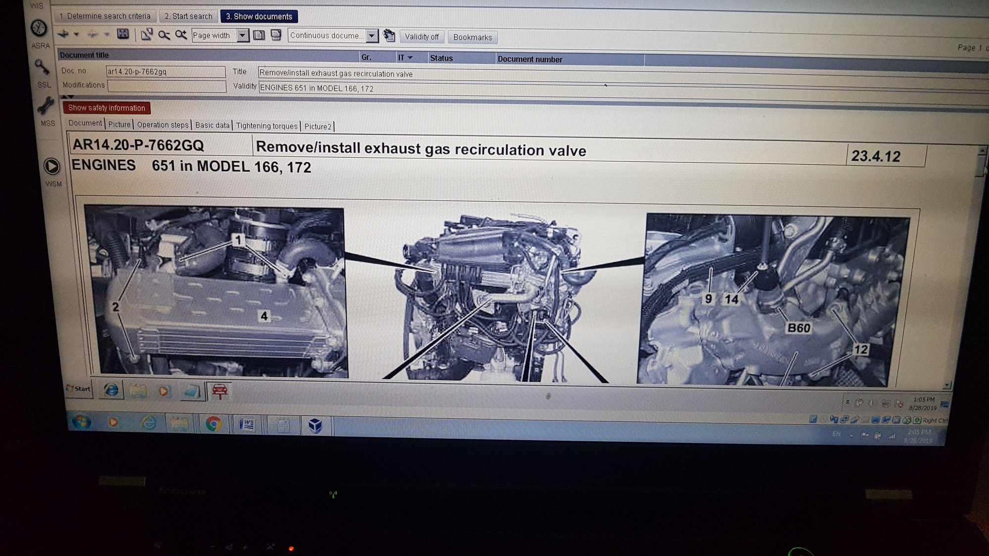

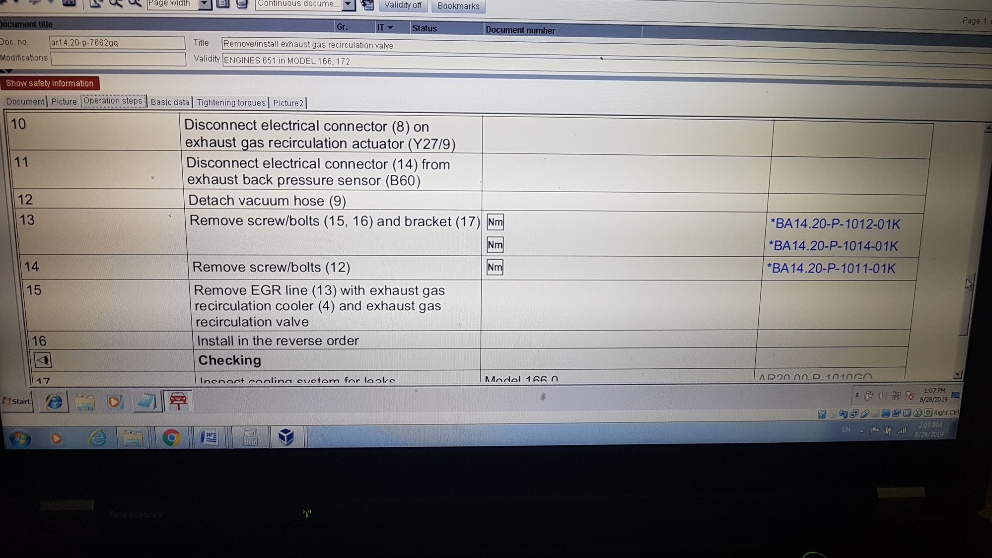

hey man, i couldn't figure out how to download the manual and post on here. i took few pictures of the procedure, let me know if u need additional info

Likes: 140
GLK250 ML350
damn it, the pictures order is messed up
