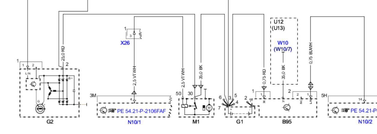

I finally chased down the schematic for the GLK, and (happily) the MB engineers did seem to do the traditional thing. ;-) Sometimes they can surprise me (though I doubt as much as the BMW engineers can). ;-)
The battery, alternator output, and starter are all tied together at the "main battery buss", which is typical since it's very difficult to fuse these items without causing a whole lot more problems than you are potentially solving. I do think there's a pyrofuse inline with the battery, though that only comes into play after a serious accident, and won't affect anything at all until it's blown, then nothing will work (due to the fact that the battery is now disconnected).
