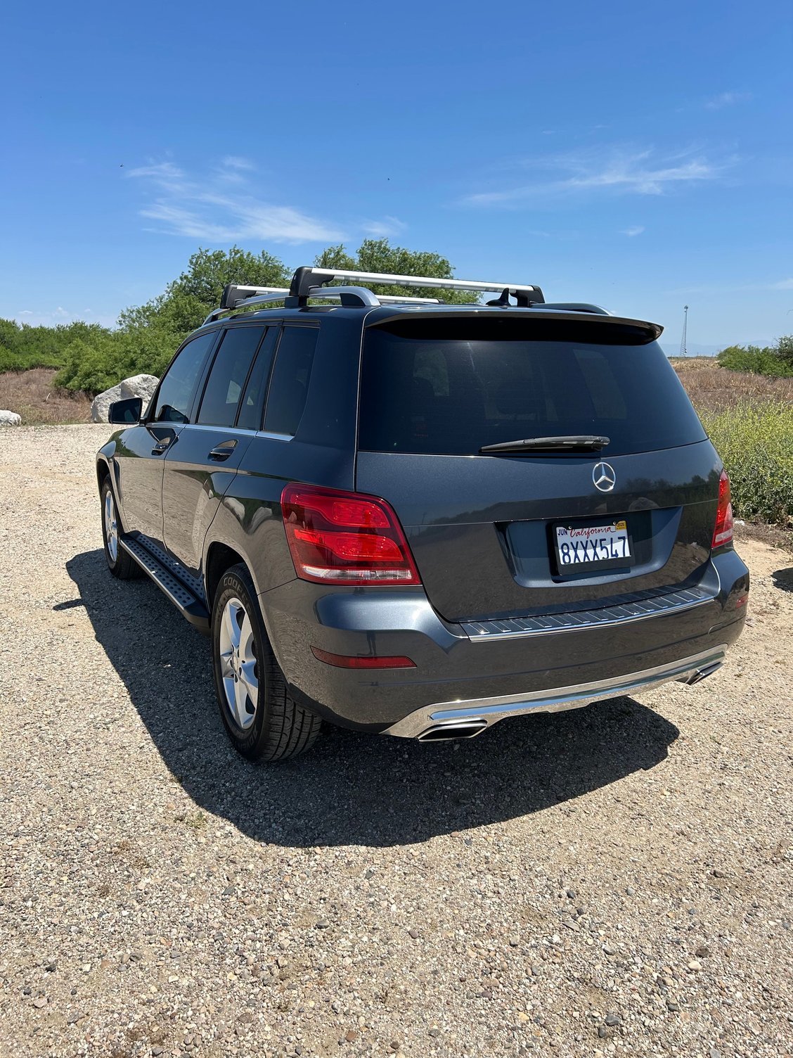

Got around to installing the 17" Metris wheels onto my GLK. I had to use the wheel bolts from the Metris as the GLK wheel bolts are too long, and may have a different seat. Just put them on today, but I like them over the 20" the GLK came with.
