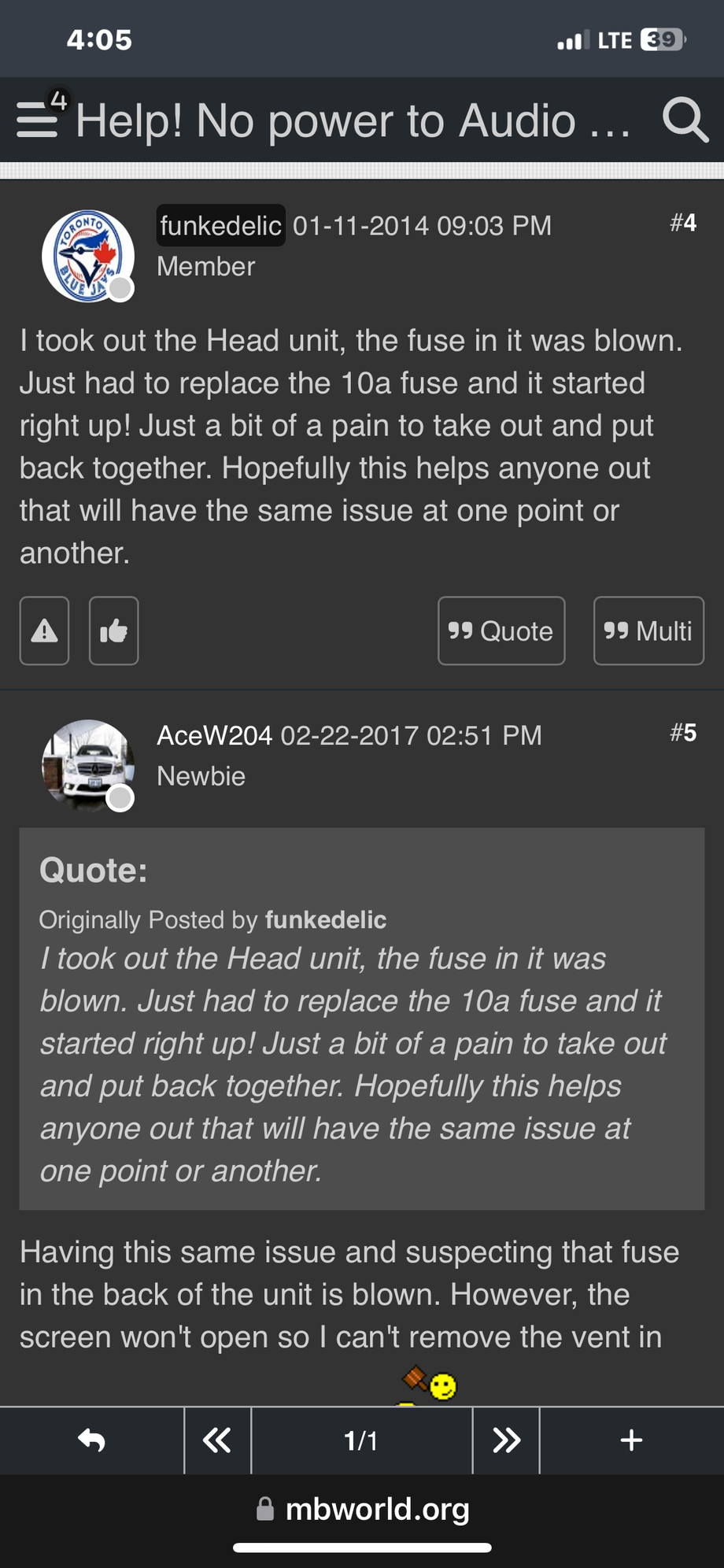

Old Oct 10, 2024 | 05:07 PM
Mmr1's Avatar
Joined: Sep 2015
Posts: 2,584
Likes: 343
2013 glk 350
This might help. Audio 20 have
an Internal fuse!

calder-cay's Avatar
Joined: Jun 2021
Posts: 1,012
Likes: 281
From: South Texas
2014 GLK350 base model (active) ; 2001 E320 base (retired); 2001 Wrangler soft-top
And for folks who prefer a link to the thread itself (for further reading), instead of a blurry screenshot:
https://mbworld.org/forums/c-class-w...ml#post5904105
