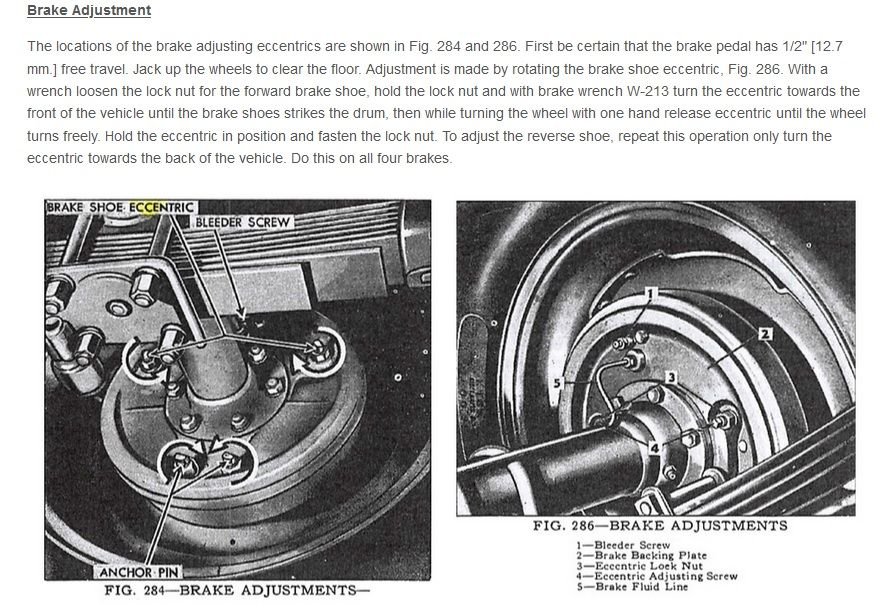

I was joking. There are older designs than that.
I remember some drums had a slot cut in the outer face where you could slip a feeler gauge in between the shoe and drum for a more precise adjustment.
I had those exact brakes on a car. But they are the service brakes. The e-brake (e for emergency) was a band that grabbed the outside of a drum on the transmission output shaft.
4 wheel power disc with 4 channel ABS was still about 4-5 decades away.

Yeah, the picture is from a '46 Jeep CJ2a. I had one back in the 1970's. It also had a drum e-brake, on the output of the transfer case.
It had a star wheel for each shoe.
