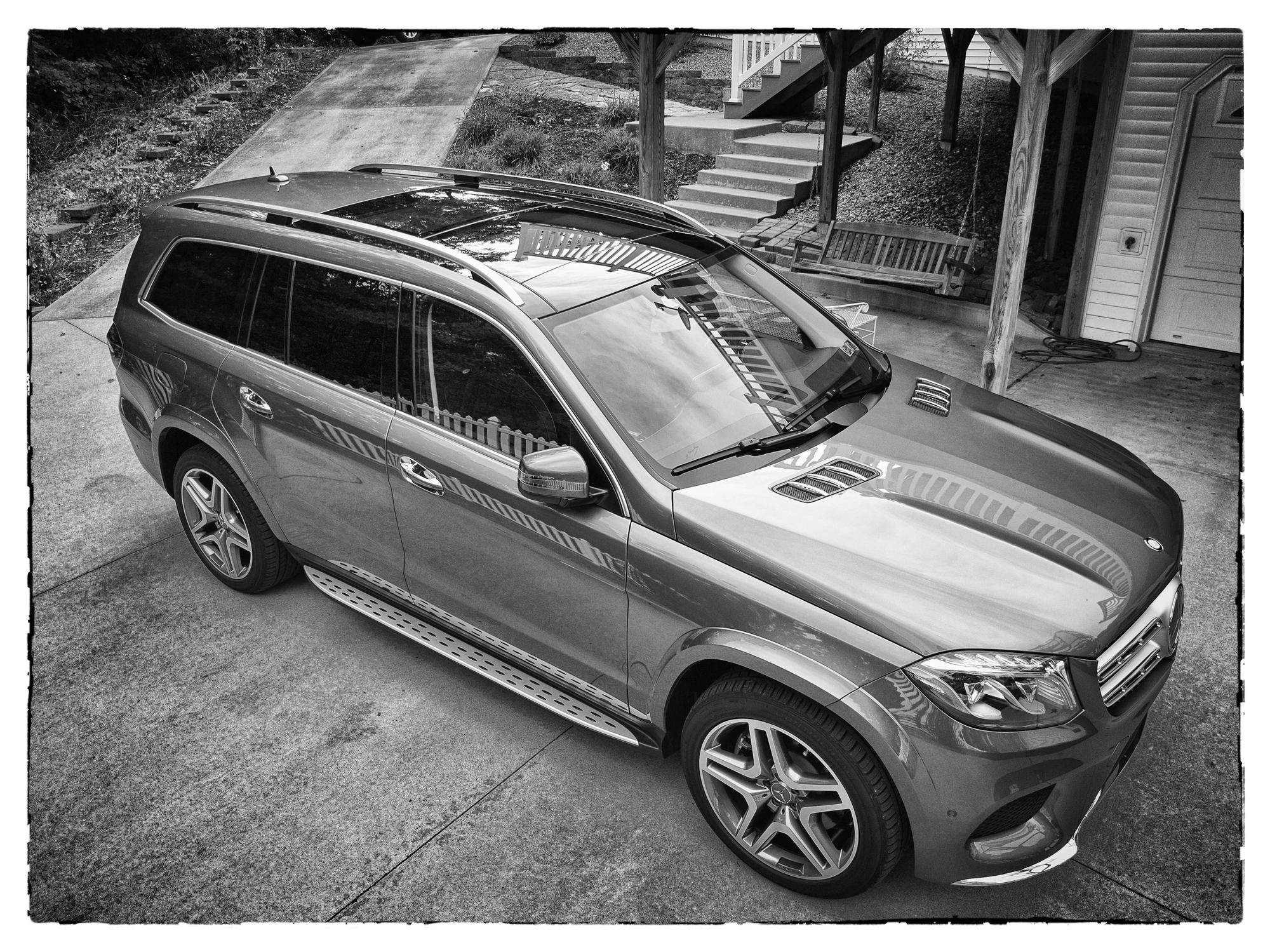

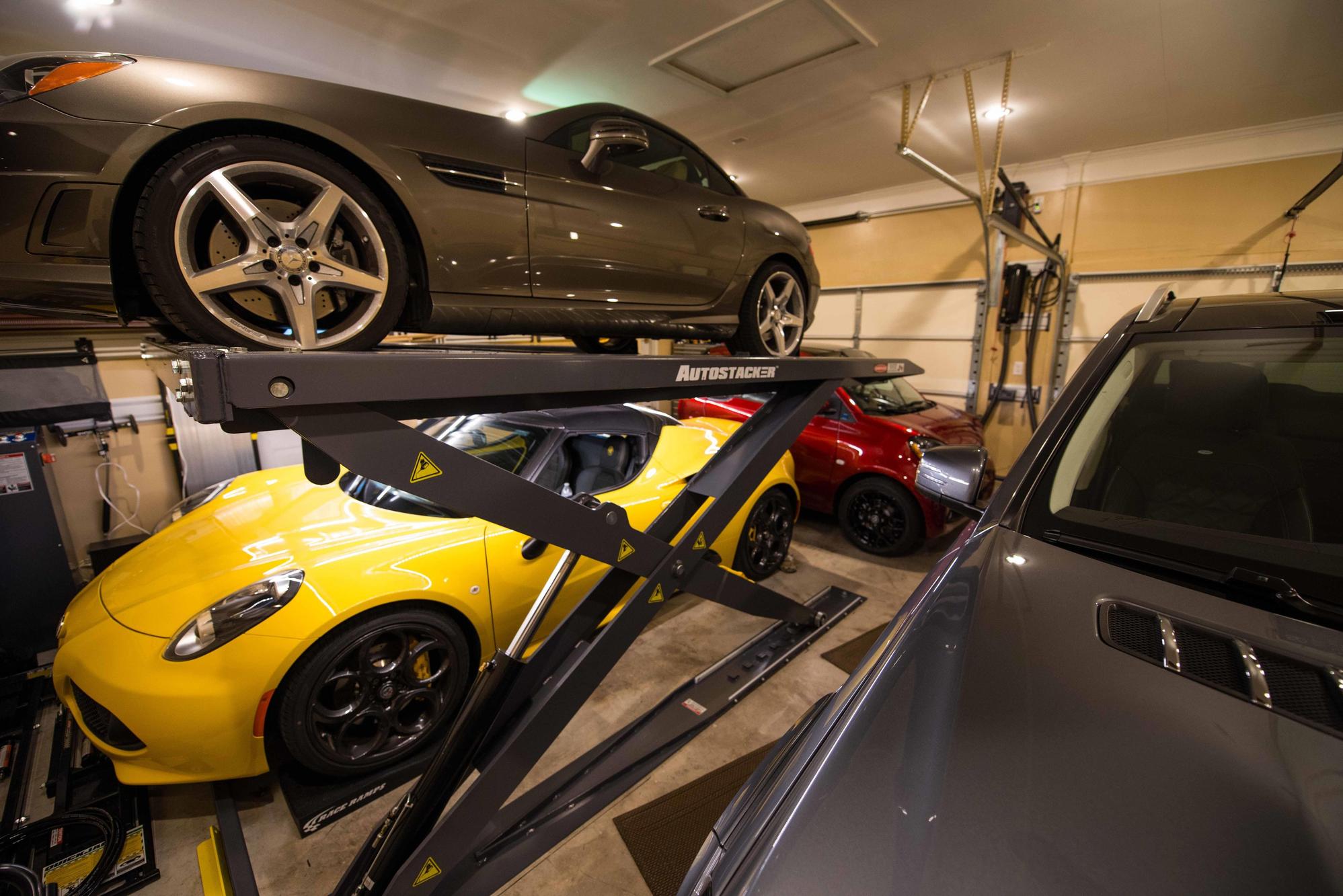

Love my GLS with 5 star. Interesting how similar your 350 looks to my 550 (mine's a 17 without the blackout package it would appear you have). Couple additional as love that the 4C is such a contra to the 550 as I loaded all but the bang olufson stereo (wanted spare tire). Then the obligatory proof that you can fit 4 cars in a 2 car garage, one being the big ol GLS.

@GeneralToner love the aerial shot of the GLS. Nice collection.
