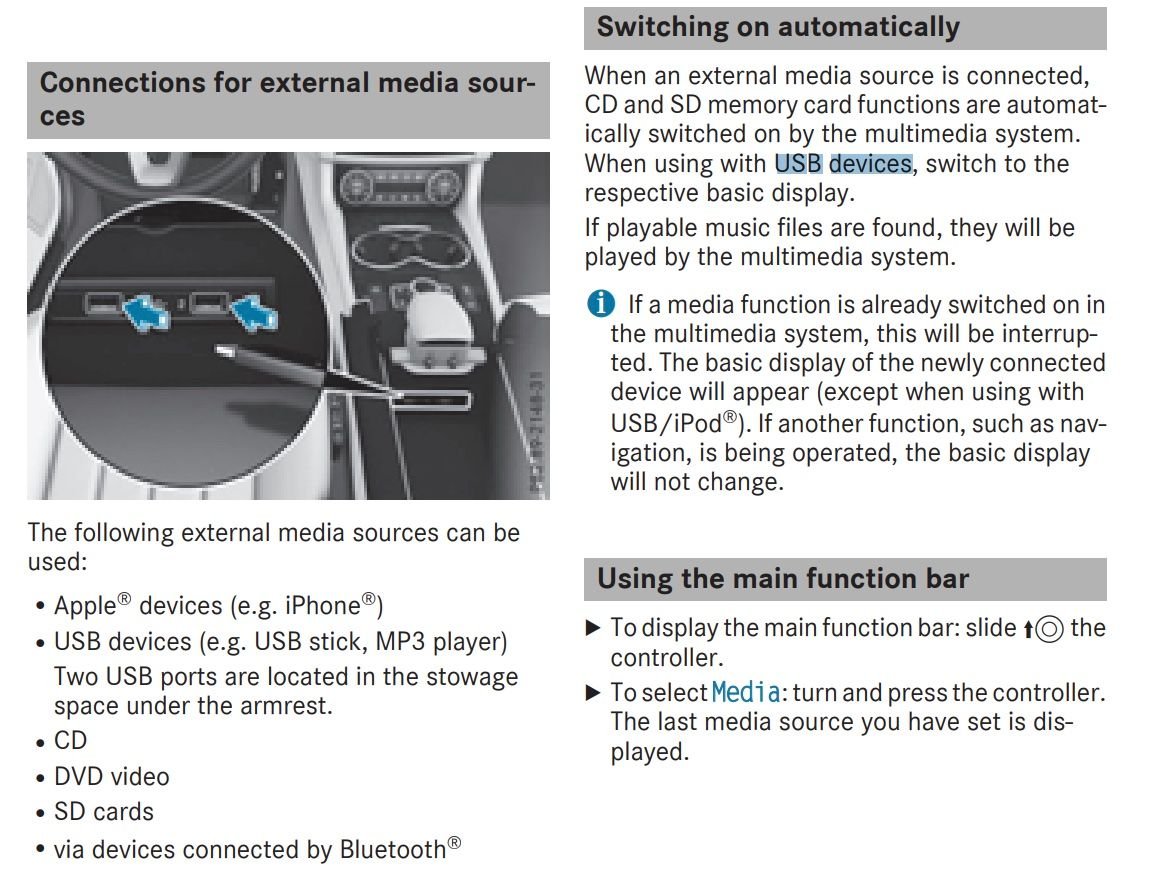

Do you have the hardcopy owner's manual? 2017 GLE manual is attached. It should be the same for all post-facelift *166 COMAND vehicles.
From page 144 of the COMAND manual:
No, I don't. Thanks for the attachment. I'll look through that and see if I can figure it out.
