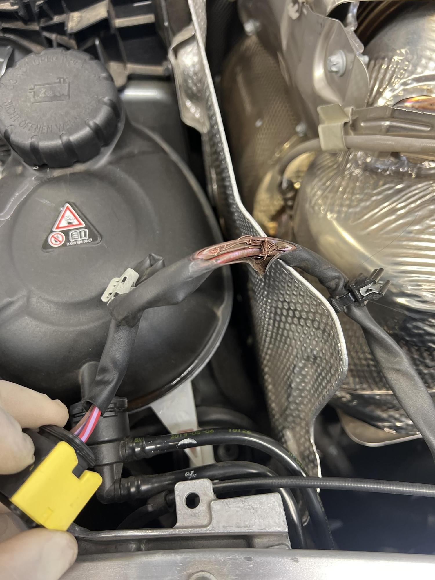

My problems turned out to be the cooling fan chafed the coolant pump cable. Even more strange is that MBZ had a recall on this problem but only for the 2019 CLS450. Mine is an early 2020--but had the same problem. I need to contact the NTSB about this---if maybe MBZ did not. --- Anyway, the fix was to re-route the cabling away from the cooling fan. The dealer paid for repairs. The car works great now.
