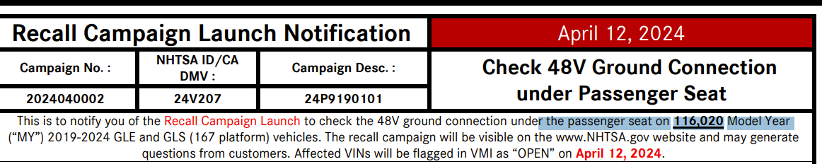

I actually just did a search and found that the 48V issue extends all the way to 100 of thousands of Mbenz cars, including up to 2024 model years. The last update was actually 2 years ago in 2024, so am not sure what the current status. Sounds like they were extending this issue to more models and years over-time.
The small number you see in some articles refers to the (dealer inventory) count but not the total recall population. One old example below. Am not sure what is the status as of 2026.
https://static.nhtsa.gov/odi/rcl/202...4V207-9315.pdf
I hadn't seen that. It's different from the fuse box ground.
The text in the document (which I downloaded, thanks) says
"VMI must be checked before performing campaigns to verify that the campaign is required on
a specific vehicle. Always check for any other open campaigns and perform accordingly
The wording is similar to the 18 car non-recall for '21's.
It's certainly not clear fron that document, but I doubt there's hundreds of thousands.
My VIN shows three recalls- fusebox ground, passenger seat ground, and MBUX blank screen, all inspection only, completed.
The video looks like a possible seat grounding issue. A reason to check the recall sources, or have a Dealer do it.
The MB recall tool is:
Recall Information | Mercedes-Benz USA https://share.google/ghkx6DP32tygVWPjz
It is.
It's already written there, that (as for April 2024) the "Total Recall Population = 116,020" cars. There are several other campaigns of the same, and the numbers kept growing. I do not know the numbers as of 2026 bu they were already in the 100,000+ range as of 2024, including 2024 model years.
As for the guy from the video, the reporters said that his VIN didn't have any open recalls.

Originally Posted by S_W222
It is.
I actually had that recall already done on my GLS.
Because of liability, NHTSA now groups what used to be advisories, voluntary recalls and Campaigns as "Recalls."
In the case of the 2021 fuse box "recall," (wrong calibration on a new screw gun) there were only 18 cars affected, their VINs were known and the owners directly notified, but all 167s were "recalled."
I'd be more curious about how many were inspected and found to be faulty.
Yours and mine were recalled and found to be fine.
I think there should be a clear difference between Recalled and Defective. As it is, this type of public dissemination dissuades manufacturers from being open.
