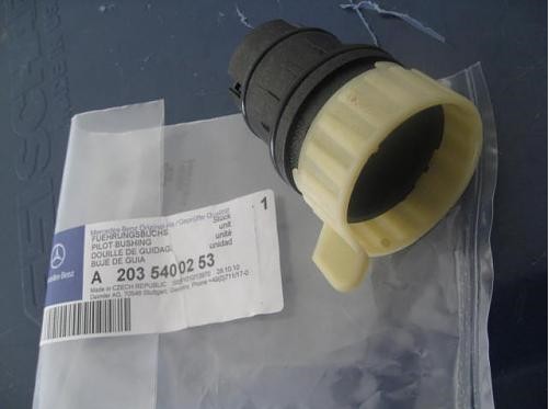

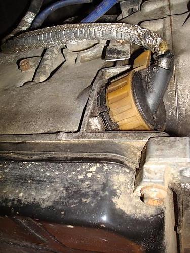

How did you change the TCC solenoid?
On the right side of the transmission you will find a 13 pin connector. Separate it and in all probability you will find trans. fluid between the two halves. If so, the connector must be replaced with an original equipment part purchased at a dealer.
Code P0743 is a transmission code which is reported by the ECM, and as a result a 3 digit code is stored in the ETC (Trans. Control Module). That code will be either 005 or 101.
After replacing the 13 pin connector and the little fluid that you lost doing so, you must clear the P0743 from the ECM and then you must clear any and all codes from the ETC.
If you do not clear the codes from each module separately you will continue to be in Limp Mode.
Do you understand everything?
