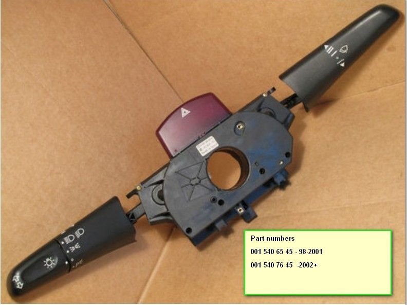

What does this mean...........I thought that it was the multi contact that was defective so i bought a used one that was working,
If you don't show us what you are talking about, then how are we going to help you?

What I meant was the multi switch mounted on the column as in your picture.
