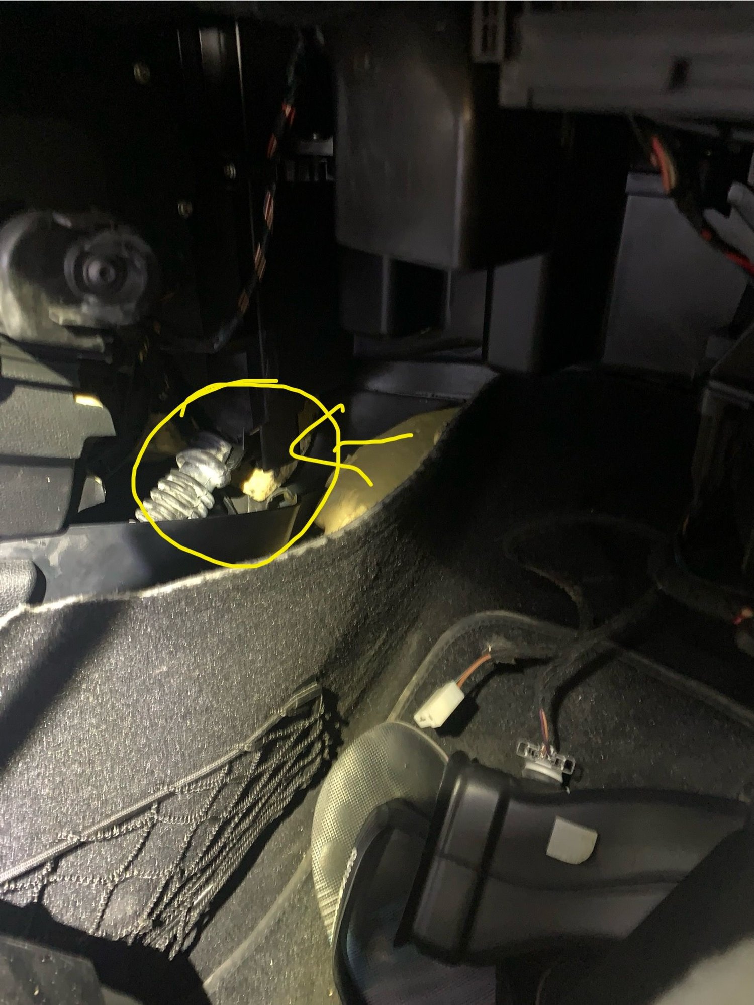

Old Sep 17, 2024 | 07:15 AM
Sandockan's Avatar
Joined: Sep 2024
Posts: 12
ML350 W164
Not sure if you are still interested, but the drain tube is located at feet compartment behind radio/cd. There is a tube by each side like in the picture. From there the evaporator can be reached as well.
Old Sep 18, 2024 | 06:45 PM
mferioli's Avatar
Joined: Jul 2018
Posts: 69
Likes: 8
2010 ML 350 Bluetec 4MATIC
I actually found those lines a couple of months ago while I had the console out for other work. I have a borescope now, so i'll take a look in there and see what it looks like, then maybe shoot some cleaner foam directly in from those ports. Spraying it in from the fan ducting only works for maybe a couple of weeks, so I don't think the foam is getting to the heart of the issue.
