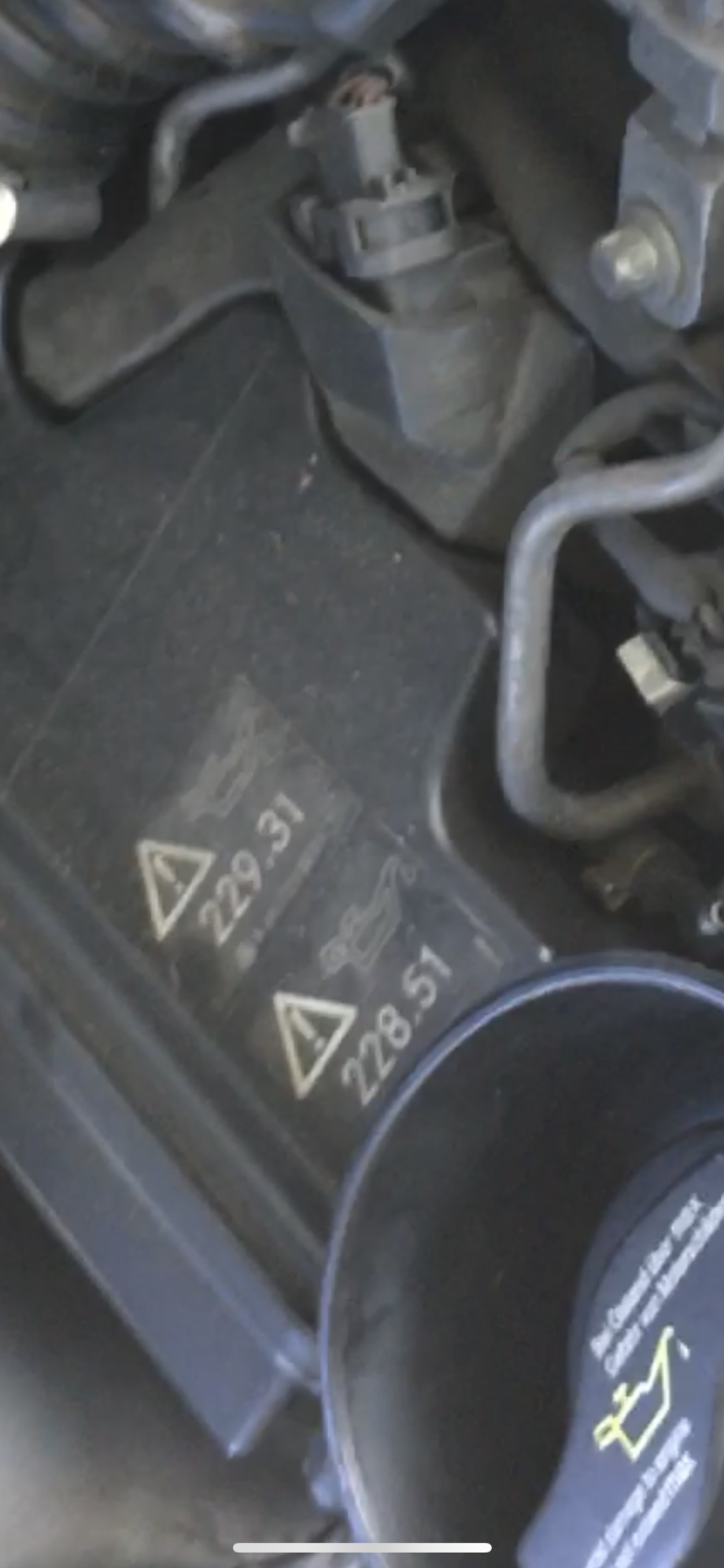

When I checked under the hood there's two stickers showing up 229.31 and 228.51. Will rotella 5w-40 be okay or just stay with the pennzoil 5w-30. Is the pennzoil 5w-30 be okay in florida or is it light oil. It been really hard to find the 5w-40 that are 229.51 in stores or 229.31. Thank you in advance.

I know this is a sensitive subject when it comes to motor oils, but since my car shows bellow in engine compartment cant i just use the Rotellla T6 5w-30 as its avaialbe all over the place.
Do our cars take both 5w-30 or 5w-40 full synthetic or it doesnt really matter which weight to use.
Im in floirda and it gets hot here.
