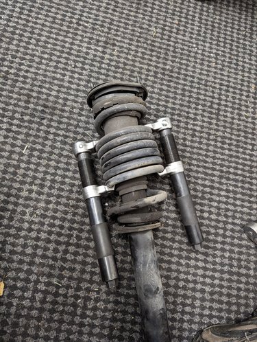

The fronts were more work. The spring rate is fairly high (the hat says something about 1300 lbs.) and you'll need a good spring compressor that can compress at least six of the coils to release the tension on the hat. I started with old spring compressors I've used in the past, but they started bending and binding once the spring had significant compression. I didn't feel safe compressing further and remembered I had a newer set I've never used so I decided to give them a try. They worked much better, but I had to compress 6 coils completely to get tension off the hat.

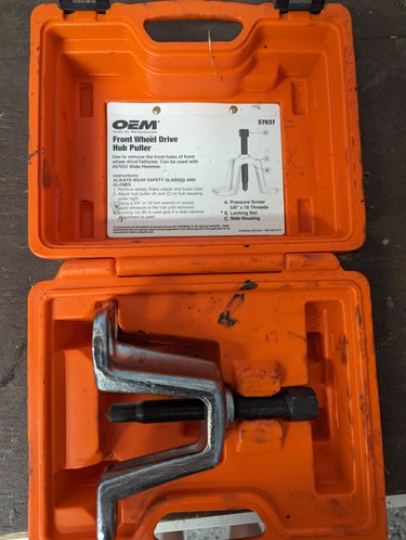

Next, the WIS calls for removing the axles to get the shocks off so you'll need a stout impact or long breaker and and socket (36mm) to get the axle nut off. I had to use a front hub puller to push the stub axle out of the hub once the axle nut was off. You'll need to pop the upper control arm off, disconnect the sway bar link and turn the steering wheel to get enough clearance to get the stub axle completely out of the hub. Use a pry bar to pop the other end out of the front differential. I saw a video somewhere of someone using a long pry bar to force the lower control arm down enough to get the shock off without axle removal, but I was worried about damage to the control arm bushings because of the amount of rotation needed. Not that difficult of a job, but make sure you've got the correct tools lined up before starting.
Old inadequate spring compressors
New better spring compressors
Hub puller to push axle out of the hub

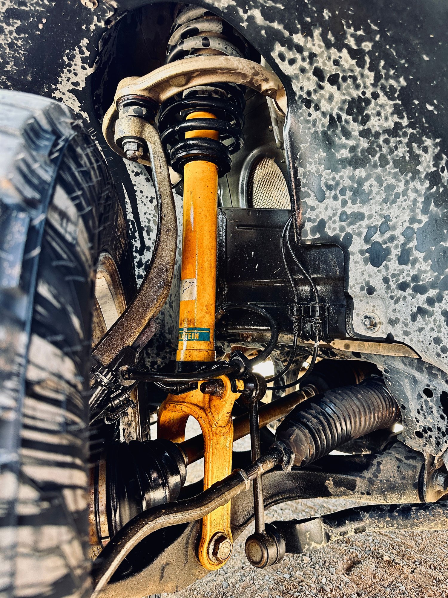

Bilstein B6 Performance
I replaced all 4 strut with Bilstein B6 Performance with original springs and I love it. I do light overlanding with my ML350 4Matic but B6 does great on road and off-road.

I upgraded to B6 Performance from stock shocks and I can feel B6 is firmer/stiffer than stock shocks.
