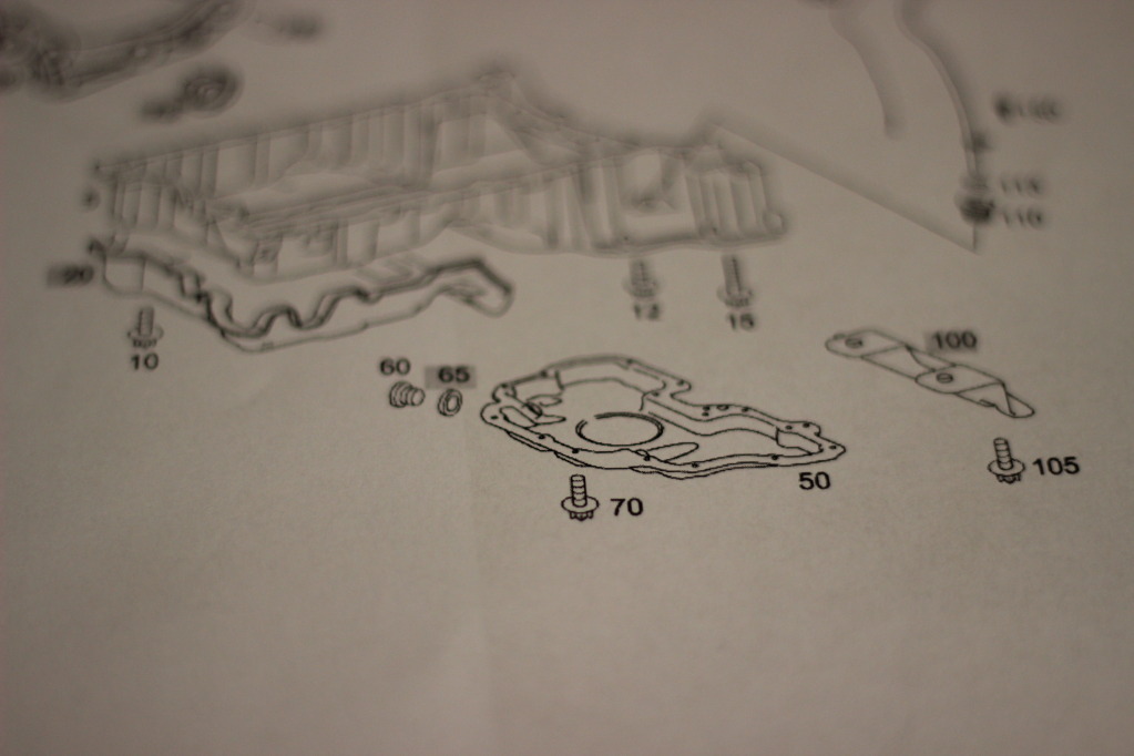

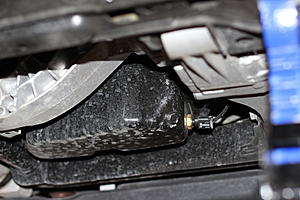

Getting to the oil drain plug
Originally Posted by 300DTurbo
if you have schematics or info on how to get to the drain plug that would be very helpful.
What I won't do for you guys! This is an ML350 BlueEFFICIENCY (gas) engine.
1. Jack up front end one side at a time using a floor jack at the double pads just behind the front wheels. I placed jack stands under the lower control arms.
2. Remove the undertray (8 screws with large washers); an impact driver w/ 5/16" or 8mm nutdriver bit workswell.
3. Drain plug is at the bottom left of the deep sump (labeled in the photo below); takes 13mm socket. Because of the sump depth and location it looks like it will drain all oil with just the front raised, vs. having to be level.
In the foreground of the last photo is the distribution block for the Active Curve hydraulics. Your truck will likely not have this.

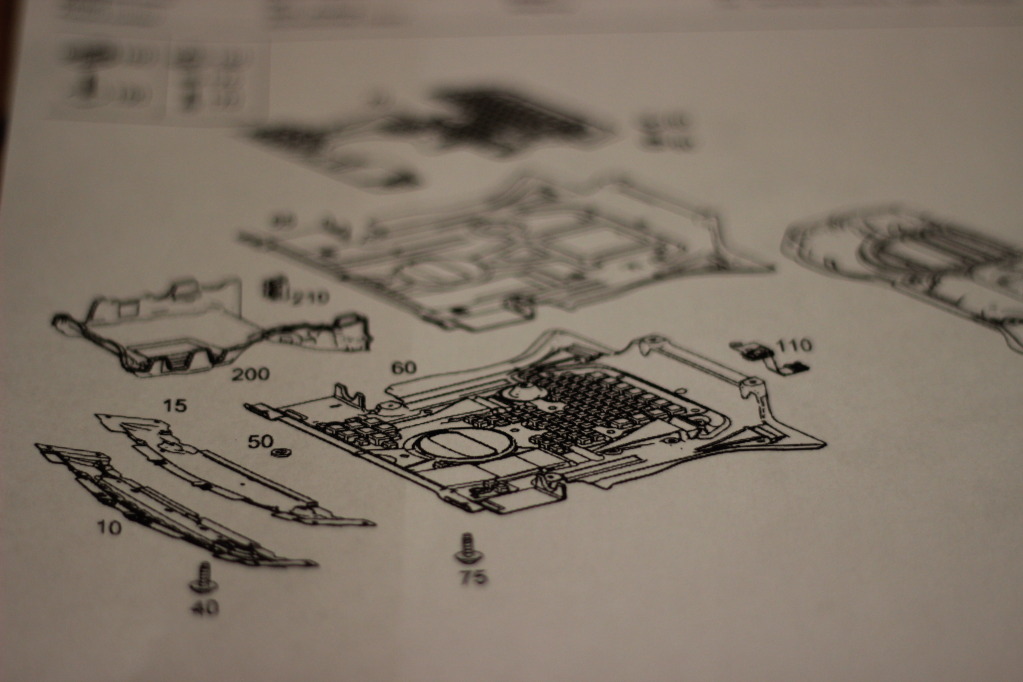

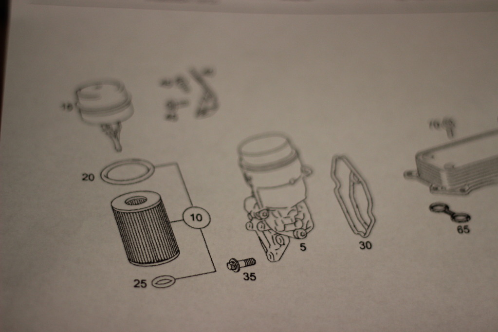

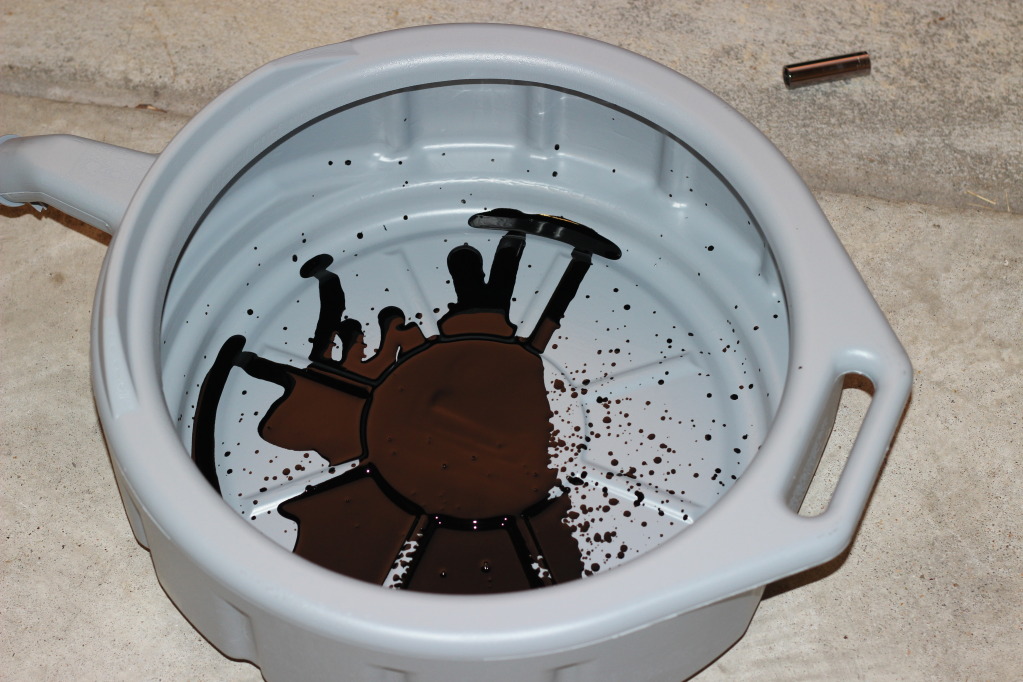

DIESEL OIL CHANGE DIY
Greg Thank you for posting these. You must have been doing this while I was uploading the pics.
I did an oil change last night and just got around to posting these images for you all (Diesel).
Here is the DIY for the Diesel with pics.
#1 GET SOME GOOD MUSIC

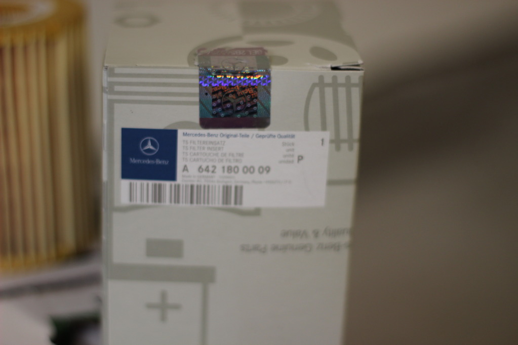

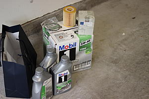

PARTS

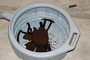

Dark Black diesel oil.

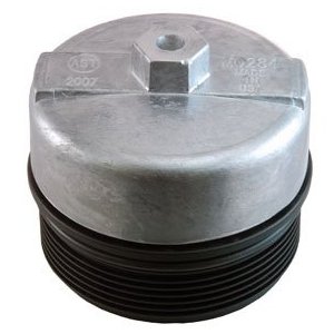

I didn't have this:Assenmacher Specialty Tools Oil Filter Housing Cup Wrench for Mercedes
As a result it took me over 15 minutes to find a good enough grip to take the filter cap off.
MANN = Mercedes Benz so just buy MANN products save some $$ Order this: http://amzn.com/B001HJ6F0W

Thanks for the excellent pics, guys.
So where did you buy that oil filter cap?
Also, the below part doesn't fit 2012 ML350:
MANN = Mercedes Benz so just buy MANN products save some $$ Order this: http://amzn.com/B001HJ6F0W[/QUOTE]
But this one does:
Amazon Amazon
