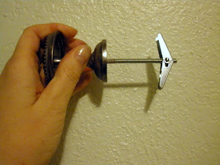

This what i did to mount my license plate without any holes drilled. This mount is very nice and alloys for a lot of adjustability, only downfall is all the screws rust out very fast, i am gonna swap them for stainless steel as soon as I get some free time. I would recommend swapping the screws out before you put the plate on. Most important keep reminding your dealer not to make holes in the front bumper. If you dont remind them they will forget and drill holes! Also bring zip ties when you take delivery, because the dealer wont be able to give you an inspection sticker without front plate. Either zip tie the plate to the front grill so you can get a sticker right away or come back for the inspection sticker after you put on your mount. The mount took me about 5 minutes to install, and other 10 minutes to play around and see which position i like.
This is the mount I used, they sell it in Autozone for 10$, its made by Bell:
http://www.bellautomotive.com/Licens...-1-46230-8.htm
The license plate mount is held by a wall anchor on the back side of the lower grill, actually this picture is pretty much what i did:
I also put some protective padding where the bracket is flush with the chrome bumper strip
You can kinda see the anchor in this picture:
And the end result looks like this:
You can adjust it up/down/in/out in many ways.
